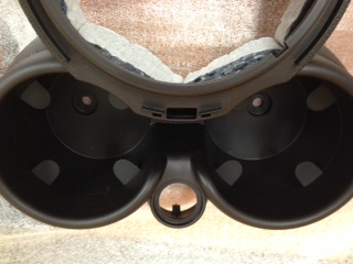

Picked up my parts today for the larger cup upgrade install.........
Center Trim Panel (51-16-9-811-185) $27.48
Shifter Trim Ring (51-16-9-810-002) $14.34
Cup Holder Rubber Disc Inserts (51-16-9-811-184) $5.69 each
Ofcourse I should of looked a bit closer before dis-assembling
Center Trim Panel, Part # (51-16-9-811-185 is for a non-nav. console....
Oh well, did a bit of house cleaning while everything was apart
I believe the correct part # for the center console with connected/Nav.
(Joy Stick) is 51-16-9-811-186, but I will confirm that with parts tomorrow..
Other than that it fit like a glove...the cup holders are noticeable larger without the spring like clips of the older style, but with new bendable rubber tabs...

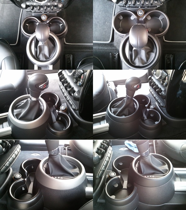

I didn't take pictures during the process but here's the before and after... original cup holder on left, 2013 cup holder on right.
