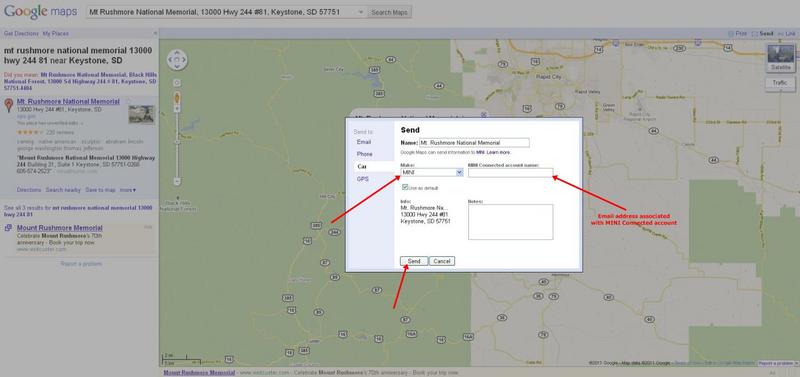

Check out the two images attached to this post -- they illustrate the Google Maps interface to the Send To Car feature. I picked Mt. Rushmore as my destination for this example.
Once you have your destination identified, find the little "Send" envelope icon in the upper left of the page. A window pops up that allows you the option to send to your car. Select "MINI" and enter in the email address associated with your MINI Connected account. Then click the "Send" button.
The next time you initialize the app in your MINI, when you choose the Google Send to Car menu item you should have the message waiting for you. The car's interface will allow you to navigate to the address you sent or dial the phone number associated with the address.
Good luck!

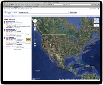

The "Send to car" option is only available when visiting the desktop version of maps.google.com. You won't be able to access it via the iPhone Maps application.
My workflow to get it is as follows:
1. Search for an address / POI
2. Click the small arrow to the right of the name and choose "send"
3. There is a car option with a field to enter your MINI Connected username

Don't you hate when you have tried everything, go to bed, wake up and try it again!!!! And suddenly it works!!!! Thanks everyone.
