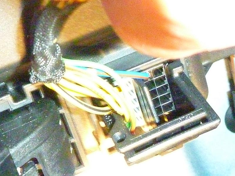

Guys i'm trying to retrofit the sport button on my cooper S all 4 (here in italy isn't standard), i need a kind soul to help me figuring out the cable setup...

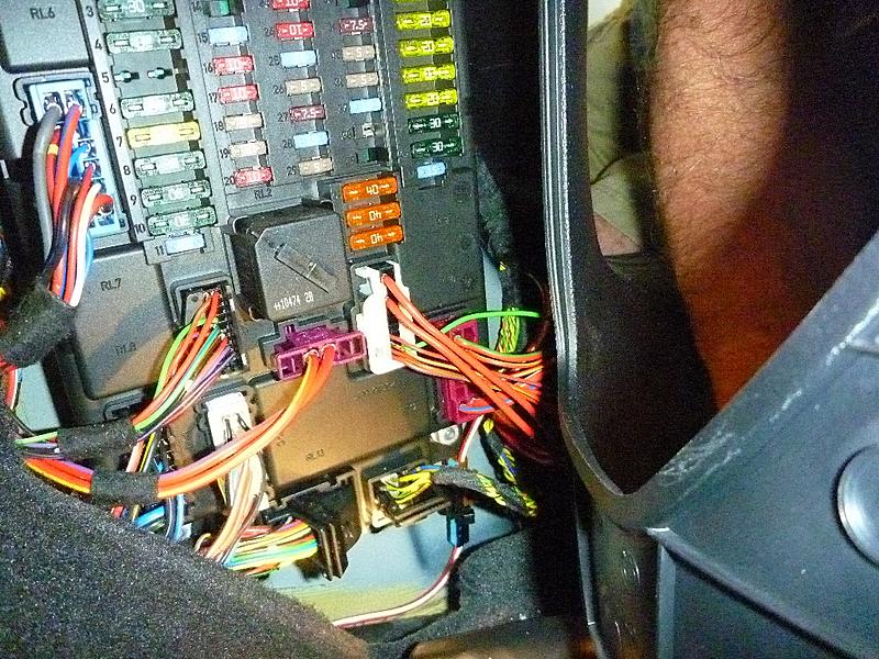

I need a picture of the connector X14272 in the JBE (Junction Box Electronics):
This is mine, and technically is missing 2 wires in the black part of the connector...
This a pic of the JBE
I need someone to look and tell me if there are 3 cables that go in the black part of the connector... Pleaseeee help me!!!

So it's located on the passenger side, bottom on the right... You can see a small "door".. By opening it u'll get the fuse box... Now u need to remove the plastic surrounding it... To remove it there are no screw, it's just a pulling thing...

Yeah, i know... I also had some thinking with just the BW pic, that's because the bw draw is horizontal while in real life the box is vertical
In this picture is the last one on the right bottom... Left near the C-G write, under the RL12...
