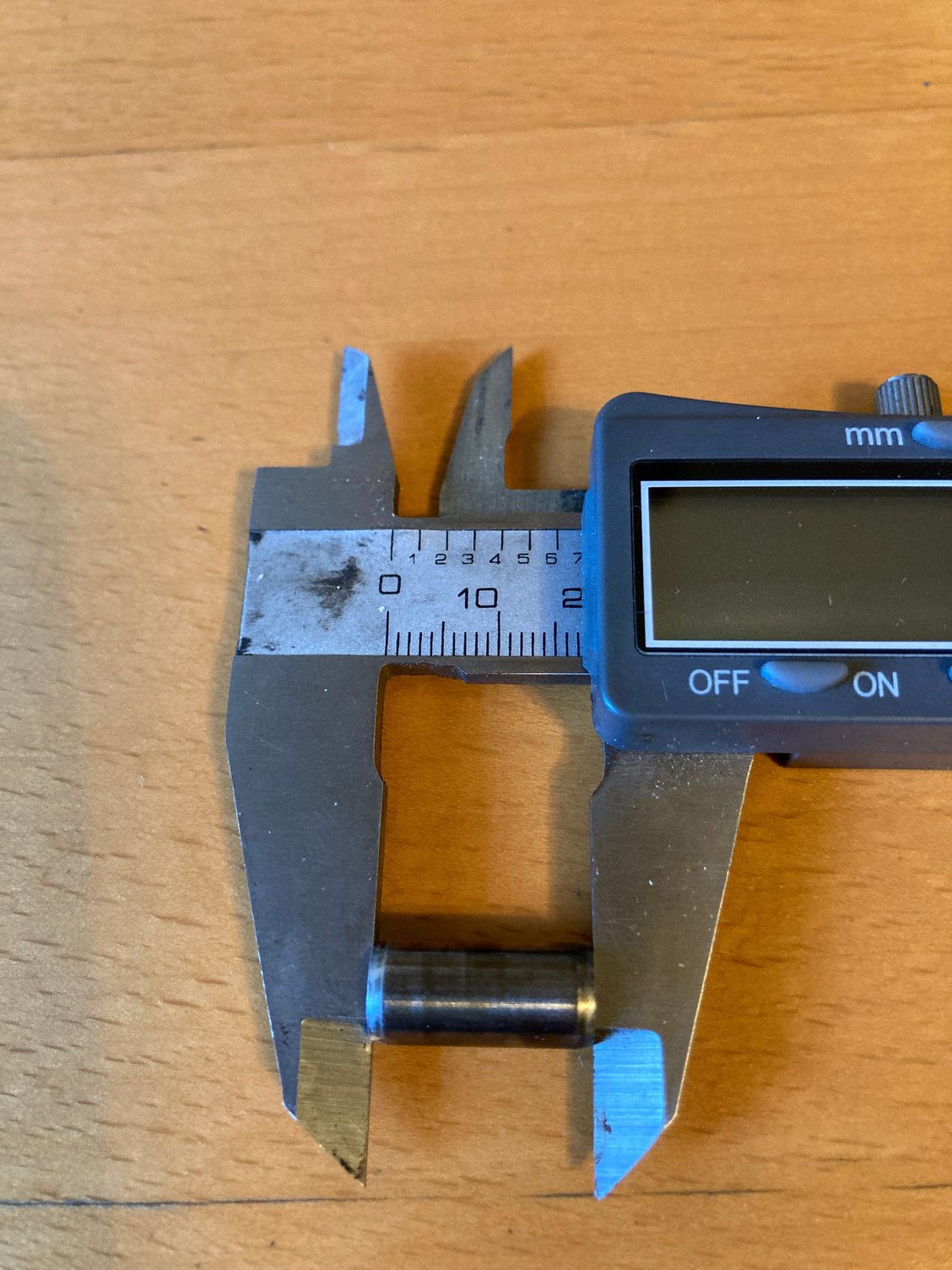

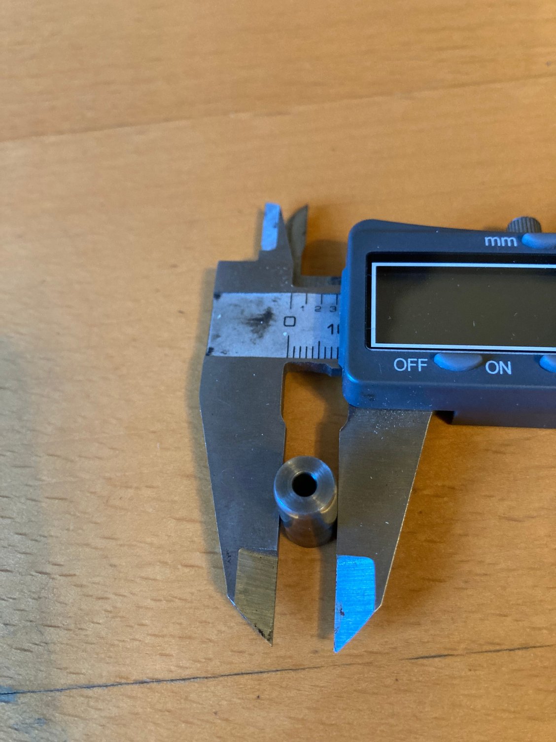

And sorry to bug, but as a platinum sponsor I was hoping you might have some insight into what the part in the pics is?
From 2009 R56/N12 base mini, found rattling on top of oil pump.
There's a whole thread about mini owners finding these in their oil pan but no one seems to know what it is.
Mike

Valve guide?

Well after looking for that online it definitely is very close visually. Except the piece I have is more than twice the listed size of that part. I don't think that is it. Especially since I didn't take the head apart until after it was off my block.
I appreciate the suggestion though!

Yes, looks like the valve guide. Might have been dropped when your valves seals were done at one time, those things don't just fall off. No genuine MINI part but we do have aftermarkets.
https://www.ecstuning.com/Mini-2009-...d/Valve_Guide/

Thanks for the response. I looked at the valve guides in the head and the diameter of the hole in the currently installed valve guides is much larger than the one on the loose part. The valves don't even fit in the hole on the loose part. So I don't think it is that. I'll keep looking.. hopefully I don't discover what it is via "recon by fire" when I get the engine running again!

Weird, looks so close to the same design. Let us know what you find.
