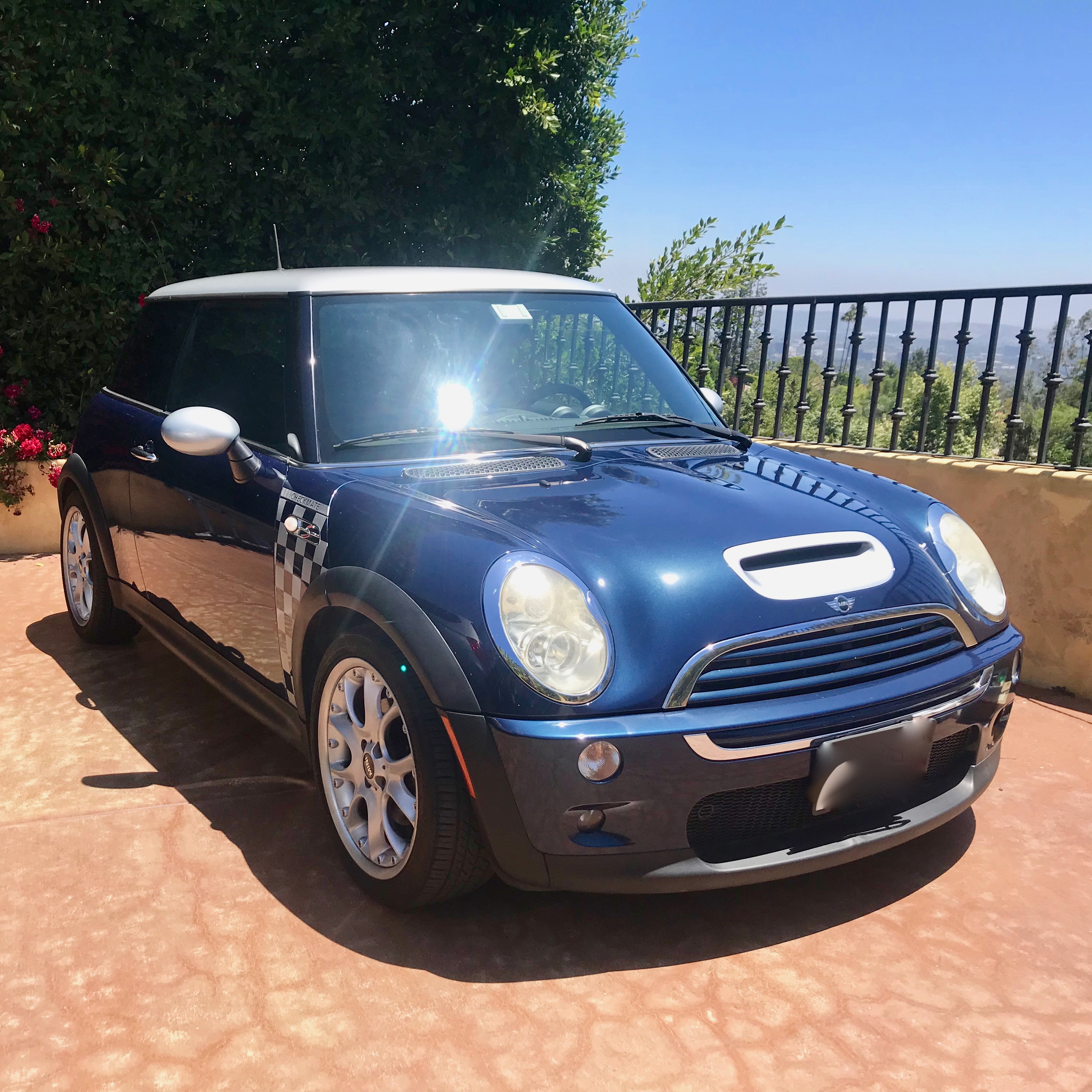

I have had my Mini for over 2 years now. Picked it up with 68k on it and only added a few thousand miles to her. I came from a E46 M3 (miss this car a lot).
I can say I didn't like the mini as much as I thought I would over time. But now its growing on me and I think Its time to start upgrading a few tings here and there.

Welcome. Nice checkmate edition.

Thank you, I don't think its a real checkmate. I have looked up the vin and no where do I see that listed.

So its not a true checkmate, they just added items. Standard seats and steering wheel?
