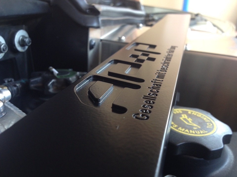

Not to spill more milk, but you should've gotten VIP plates+bar or ECS or Cravenspeed strut tower plates. The under plates obviously weren't enough if you still have mushrooming & they lift the fronts a bit. I used the AP+P bar on Craven combo. No hood bulge....Best MINI strut bar out there.
that looks like a quality piece, I'm hoping ECS might add a strut plate and bar as an option in the near future.
