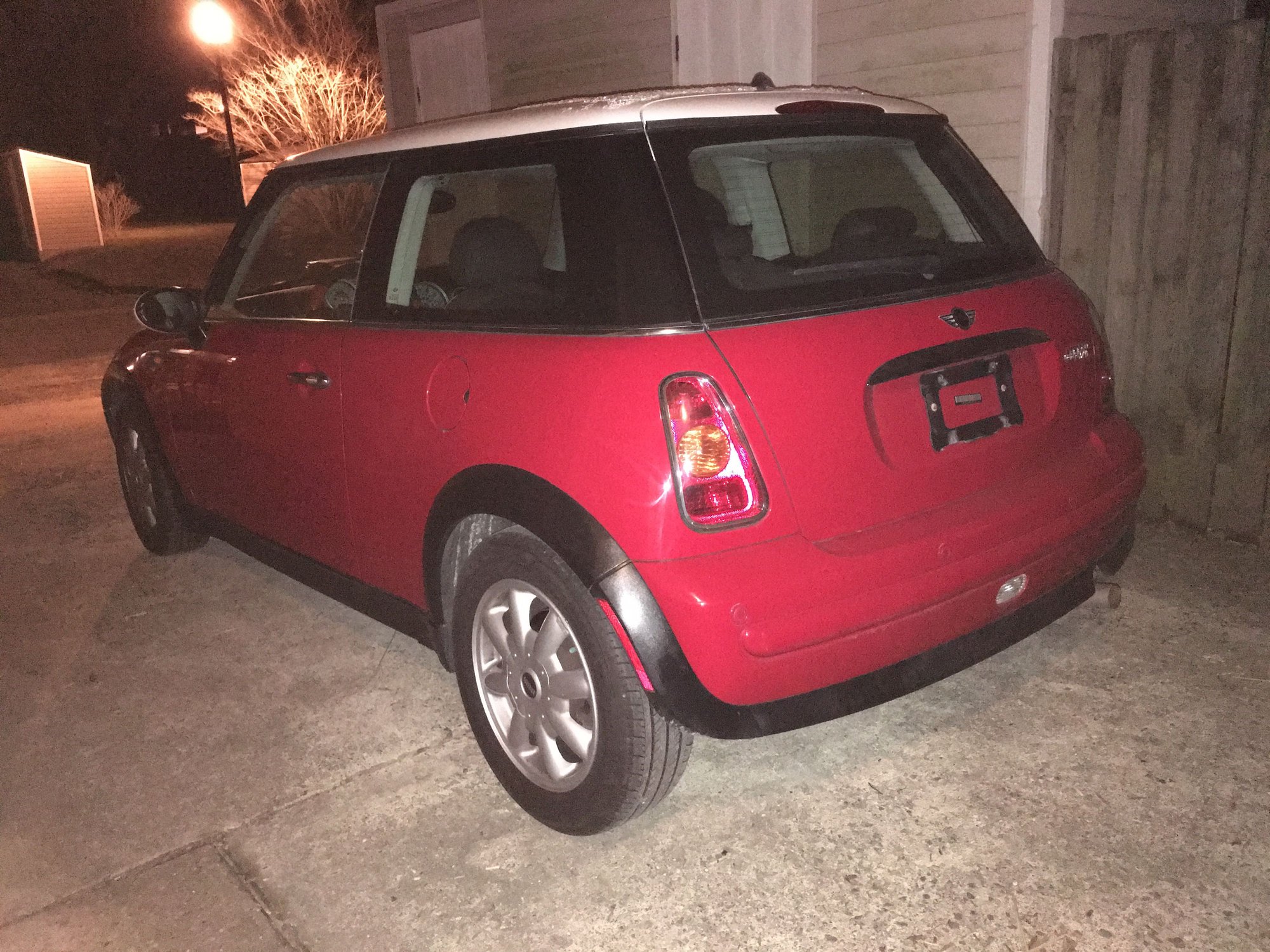

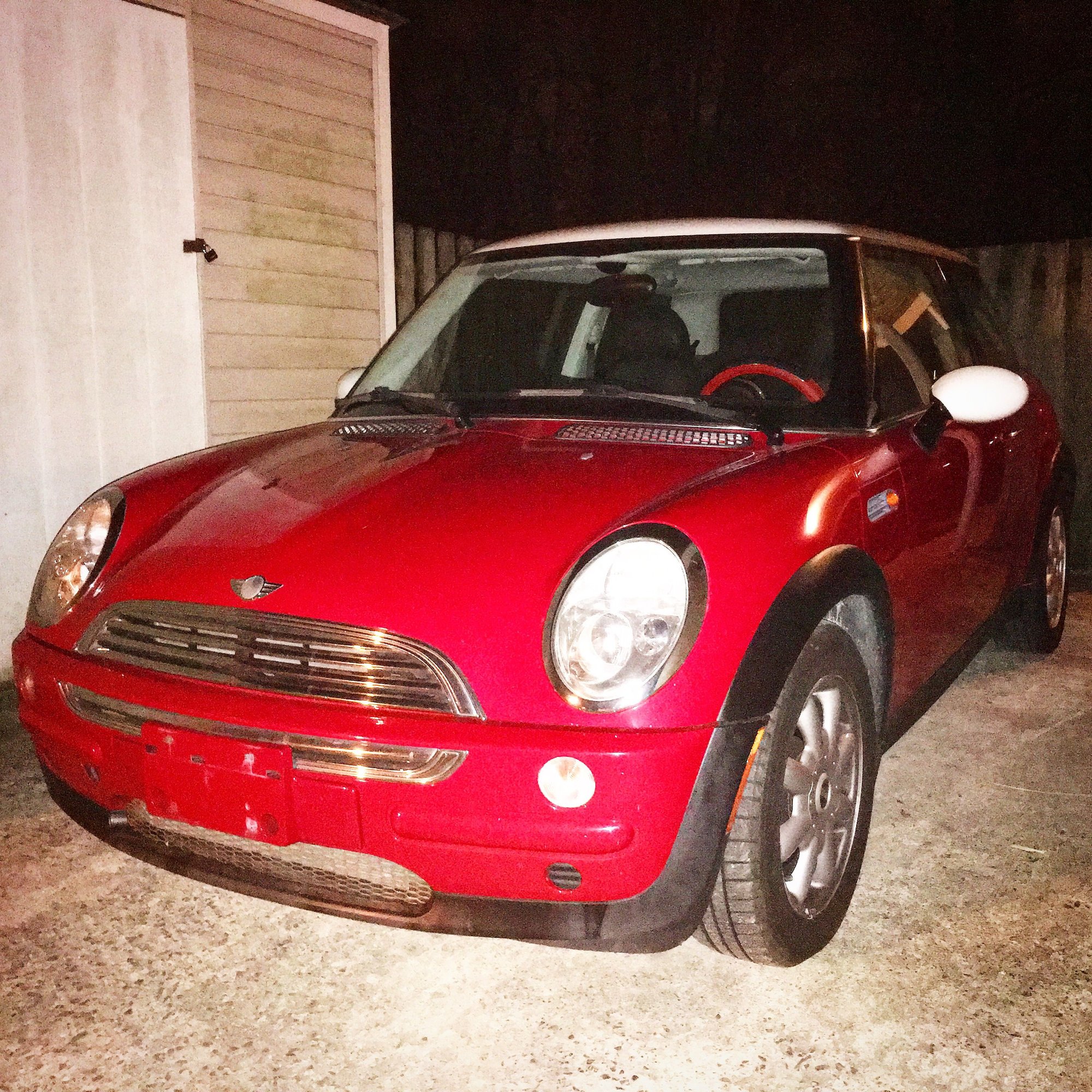

The night we picked her up. Need to go over the car with a fine tooth comb and fix any issues that come up.

Thanks for the pics. Congrats. Looks like you have the popular wheels for the early R50's . You don't have a factory exhausts tip , possible the exhaust was replaced or its just missing. 82122210098
https://www.ecstuning.com/Search/SiteSearch/82122210098/
The chili red with the white top is a classic combo, one of my favorite.
The antenna is missing, just go with the stubby version looks much better .
Two version, had them on mine , no reception loss except for a little on AM side.
MINI newest version 83mm
We even have the older MINI design in URO version 105mm .
http://www.ecstuning.com/Search/SiteSearch/65202296772/
MINI
URO
thanks
Also the front badge on the hood center logo has flaked off. Here is all the gen1 , you will need the R50 version and some tricks and tips on removal and install.
Setting the car in the sun or heat helps pull the old one off and +1 on the dental floss trick , working for the sides first seem to help.
Removing of the foam residue the some WD40 or any other substance of similar removal chemical will work, prep the surface clean helps adhere the new one, remove all the grease.
Line it up with the pins and make sure its aligned properly straight.
Just make sure you get the correct emblem for the front. Peal and stick application.
Gen 1 R53 & R52 MINI Cooper S "Hood" Emblem is smaller Part number 51140660106
http://www.ecstuning.com/Search/SiteSearch/51140660106/ES78841/
Gen 1 R50 & R52 MINI Cooper "base" or Justa (no hood scoop ) "Hood" Emblem is bigger.
Part number 51147026184
http://www.ecstuning.com/Search/SiteSearch/51147026184/ES79249/
Also the Gen 1 R50 R52 R53 MINI Cooper & Cooper S share the same "trunk" emblem.
http://www.ecstuning.com/Search/SiteSearch/51147026186/

Thanks for the welcomes and replies. I've been taking inventory of all items needed to be replaced and had the emblem and antenna, but didn't realize the exhaust tip. Thanks! Already knew from previous owner that the glove box was engineered with Velcro as it wouldn't remain shut. Need to replace that or make a shelf. We'll see. And mom and dad took car out yesterday and put it through the paces. Pretty solid car and I see my wife wanting to drive it more already.

You are welcome. Let me know if you need anything else, those are just a few I could see from the pics.
