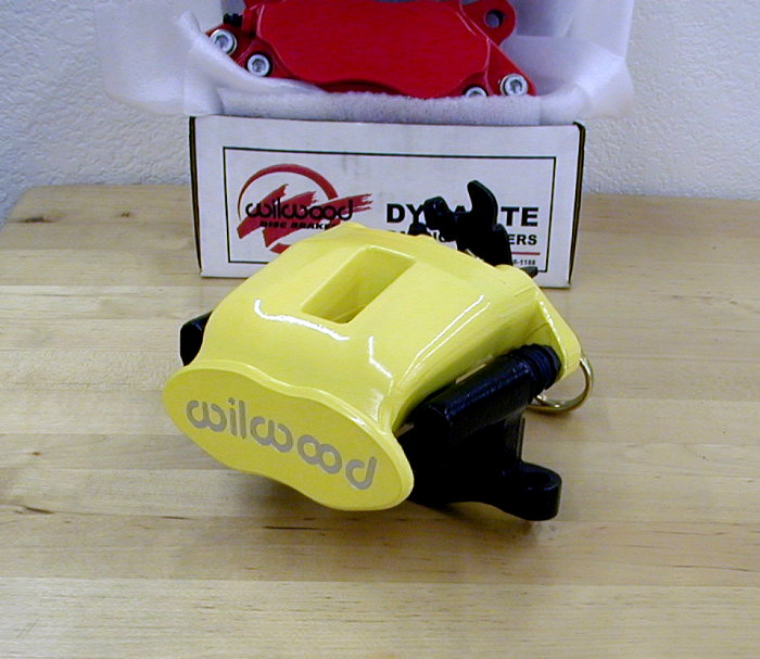

That one just doesn't work well.
Here are two from the shop. In yellow (not done to my stds) but proving I do have it!

They look good to me!
Thanks alot Todd... I told you I need to wait a month or so but you are making it very hard to wait for new brakes!

The yellow is definitely not a good shade, but the caliper looks good.

is this a floating single piston set up? What's it weigh?

That is correct. Same design as you have now.
I'm not sure of weght, I'll check. Alum bod with steel cage and alum radial bracket (soon).

Which is the difference of this for the OEM?

If I understand the question-
There is no difference in this caliper from OEM other than the matching appearance of the body when used with a Wilwood front kit. Function will remain the same; functional rear caliper with internal parking brake feature.
The caliper will be fit only to the TCE 11.75" rotor package and not the OEM rotor.

Can you get it without the Wilwood logo to match other front BBks?

Only if you or I mill off the high portion of the outer body. The logo is milled into the surface. Then you'll have a shiney body (not you, the caliper) and need to powder coat it or paint it.
