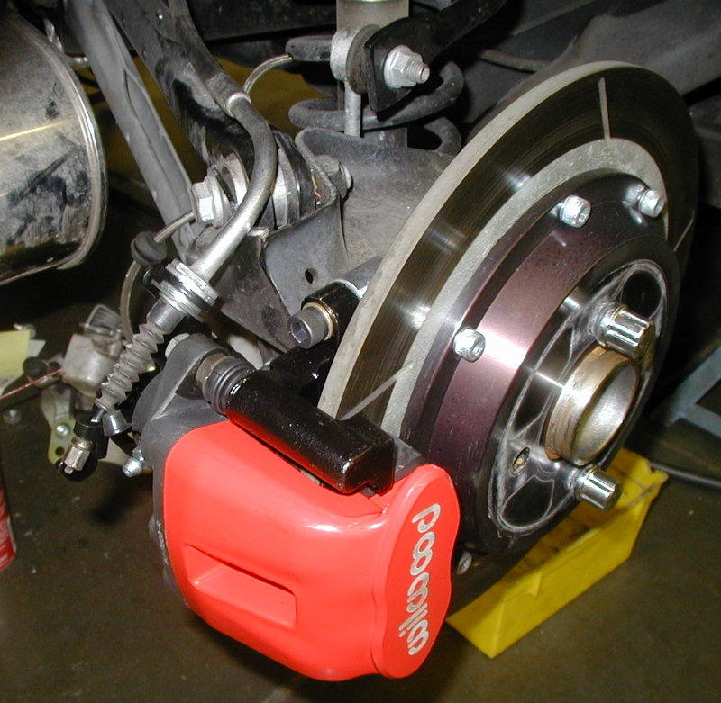

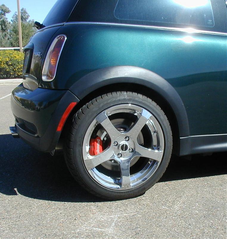

REAR KIT IN SERVICE!
Got installed today. In service as you read this.
Went pretty much to plan. Small changes here and there. In short; it will bolt up to existing TCE customer's 11.75" rear rotor kits.
Appears that it will REQUIRE the use of 17" wheels. Body of the caliper is quite large. Stock cables are retained also.
