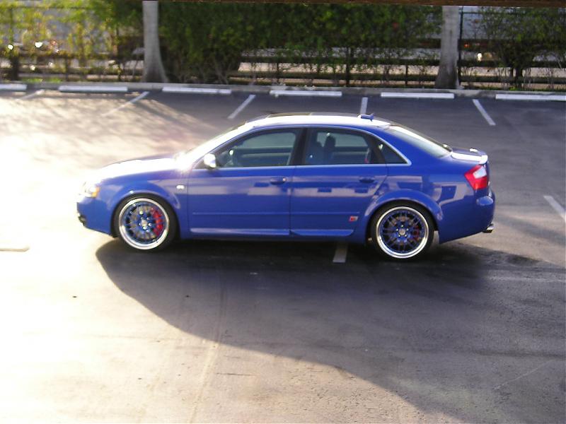

What is the baddest, biggest, most bling-bling brake system offered for a MINI? I don't track the car...just want something that looks radical...kind of like what I have on my S4.
