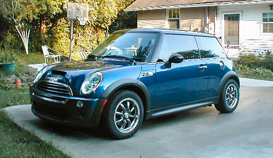

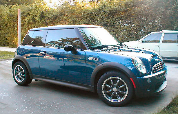

mine with graphite rewinds & 215-50s
Looks sharp, blalor. A little tint on your windows would really set things off!
Here are a couple of lousy pics of my S with Rewinds & 711 215-50s.
The tires don't rub at all and are 8.9" wide & 23.5" tall . I wanted silver centers, but found the graphites close by & cheap. They've really grown on me. When they get dirty, I decide I don't like them so much. Then I wash the car & love 'em all over again. (Wonder if this works for children & pets?)

Thanks, Bodinski! Your car really looks great! What color is that? Hyper Blue?
Tint (probably Huper Optik brand) and new viper stripes are planned at some point, but they fall below must-haves like a helmet, harnesses, and gasoline. :-)
