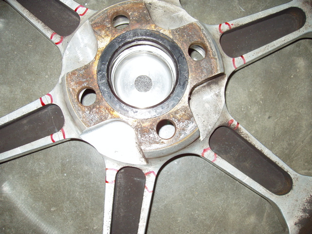

Cracked RPM's
Wheels not tracked
Attached Thumbnails Centerline RPM Cracks-pa250012.jpg   Centerline RPM Cracks-pa250013.jpg

Originally Posted by MOTORN
Cracked RPM's
Wheels not tracked
Exactly what mine did.
I'm still wondering if this is an RPM related issue or affects their other wheels.
I'm switching to Rotas - however some of my Subie friends have clued me into cracking on these rims also.
Cracked RPM's
Wheels not tracked
The one set that I saw in person which were tracked looked exactly like that as well. The center hub almost broke out of the wheel. Luckily he noticed it as he was rolling back into the paddock as it could have been a disaster on the track. The other broken wheel was just something I heard about when they called into the shop to order a different set, I did not see that one in person.
The 18 inch saga is a different story but still telling on the part of Centerline. I feel the root cause of the problem was the thin 35 sidewall that the owner had to run to get them to fit. There is not a lot of cushion there to absorb road bumps and if the wheel is not up to it you are going to bend them. When i first me t him at a Steve's Auto Clinic party he told me how he had bent two rims so far and neither time did he even realize what bump had done it. The bends were not too bad and he was able to live with the vibration and he would take care of it when he got back home to TX. Two weeks later i get a PM from him with this saga. On the way home be bent two more wheels so bad they would not hold air. He had to hold up in a hotel for a day while his mother overnighted his stock S lites so he could make it the rest of the way home. Here is the kicker . After contacting Centerline about their warranty position and seeing if he could get a replacement for the bent wheels he was told that his warranty was voided because he bent the wheels ???? I swear this is the story as he relayed it to me.
