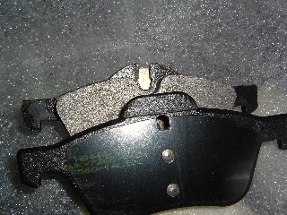

The Hawk HPS that we sell has the Correct Brake Wear sensor notch on it.

Old Apr 7, 2005 | 05:22 PM
MiniPilo's Avatar
MiniPilo
Joined: Jan 2003
Posts: 1,882
From: Wyckoff, NJ
Rear and Front Pictures
Attached Thumbnails EBC Green Pads - with or without sensor hole?-dscf0012.jpg   EBC Green Pads - with or without sensor hole?-dscf0015.jpg
