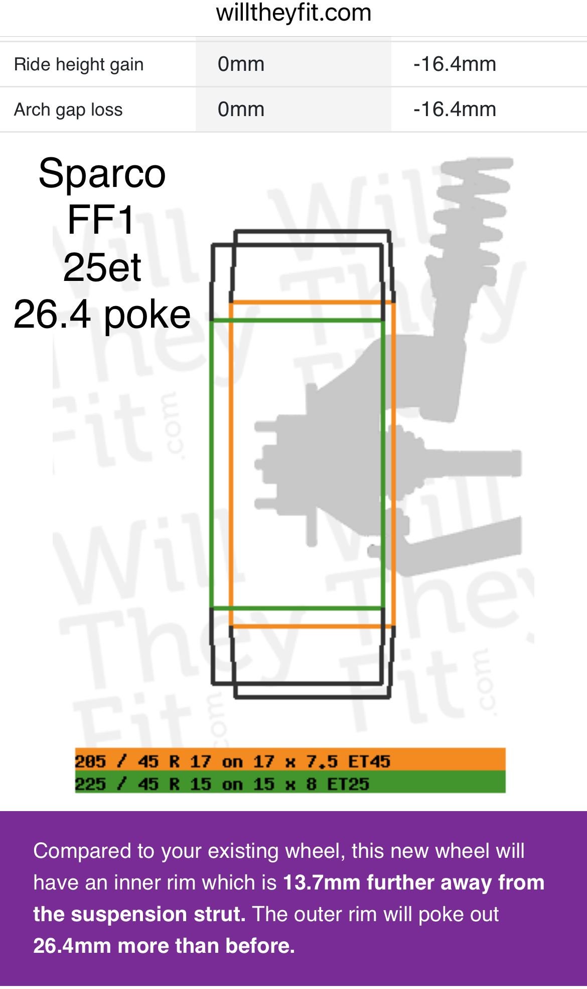

I **think** I’ve landed on the setup that allows 225/45-15, fits R56S brakes and should have no rubbing issues on a stock suspension setup:
Sparco FF1 26.4 poke (25et)
Enkei RPF1 23.4 poke (28et)
Konig Hypergram 16.4 poke (35et)

Just to 100% confirm @uffitz56 - your brakes are R56S with 284 rotors - is that correct?
I confirmed that the Konigs will not fit / clear R56S brakes, so, based on your findings and recommendations, I've got this in my cart right now:
