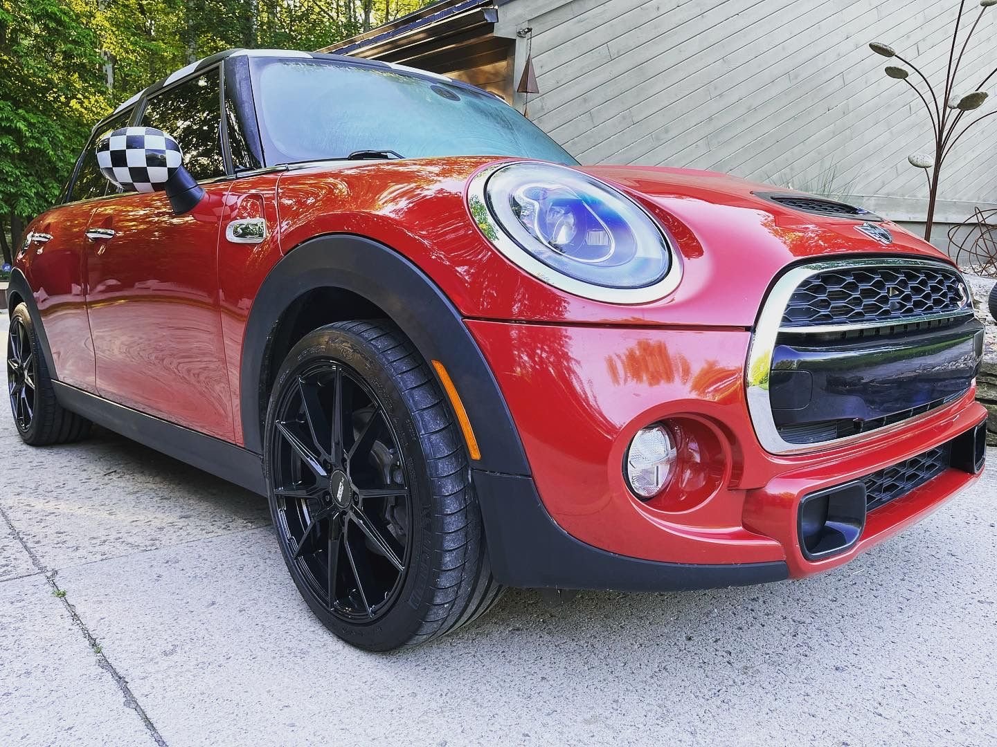

New shoes for her ♥️♥️ summer tires make all the difference. Looks nice too. Fits in the fenders a little better.
Stock - 17 x 7 et 54 - 205/45/17
New - 18 x 8 et 45 - 225/40/18

They Look Awesome! Should be Extra Grippy.

Really liking your wheel setup! Are you running stock suspension?

Yup stock suspension. I won't lie it's tight but does work. This post (not mine) but what I used to make my decision shows some clearences.

Looks great.
So, the offset is 45 mm for your wheel? Do you think it can fit on 2 Dr as well?

Should be the same on a 2 door. That post above was on a F56 (2 door) and i have an F55 (4 door).
