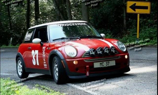

Reach out to Colinmini here on the forum, he runs them.
That is his RaceR50

White Holies and 205/50-15 Bridgestone Potenza RE-71R tires.....a very good set up! Fast! Ok, my Justa isn’t fast, but really holds it own thru corners with these tires and wheels! (Gone to a 7” wide Kosei, but still have a soft spot for Holies!)
