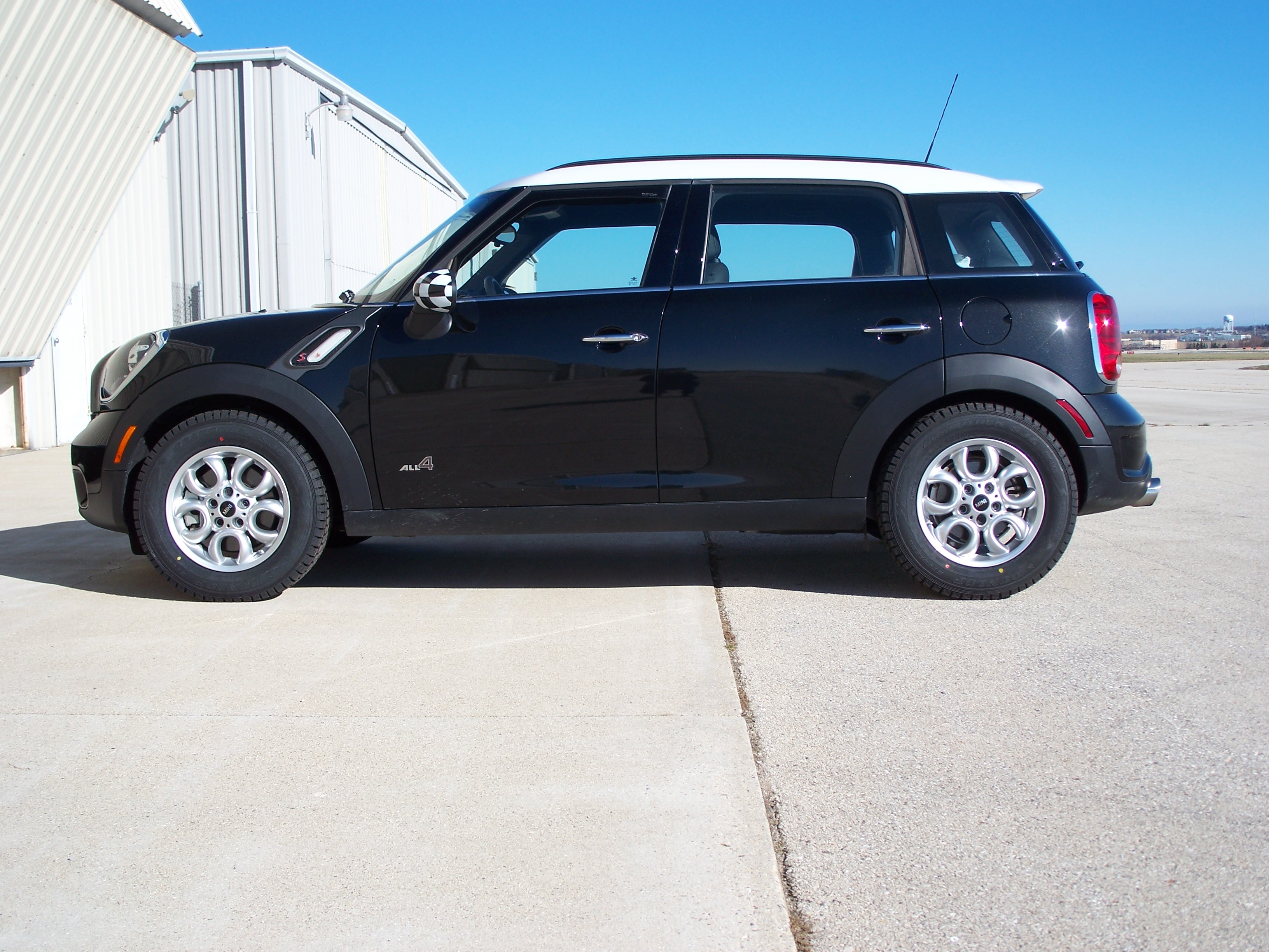

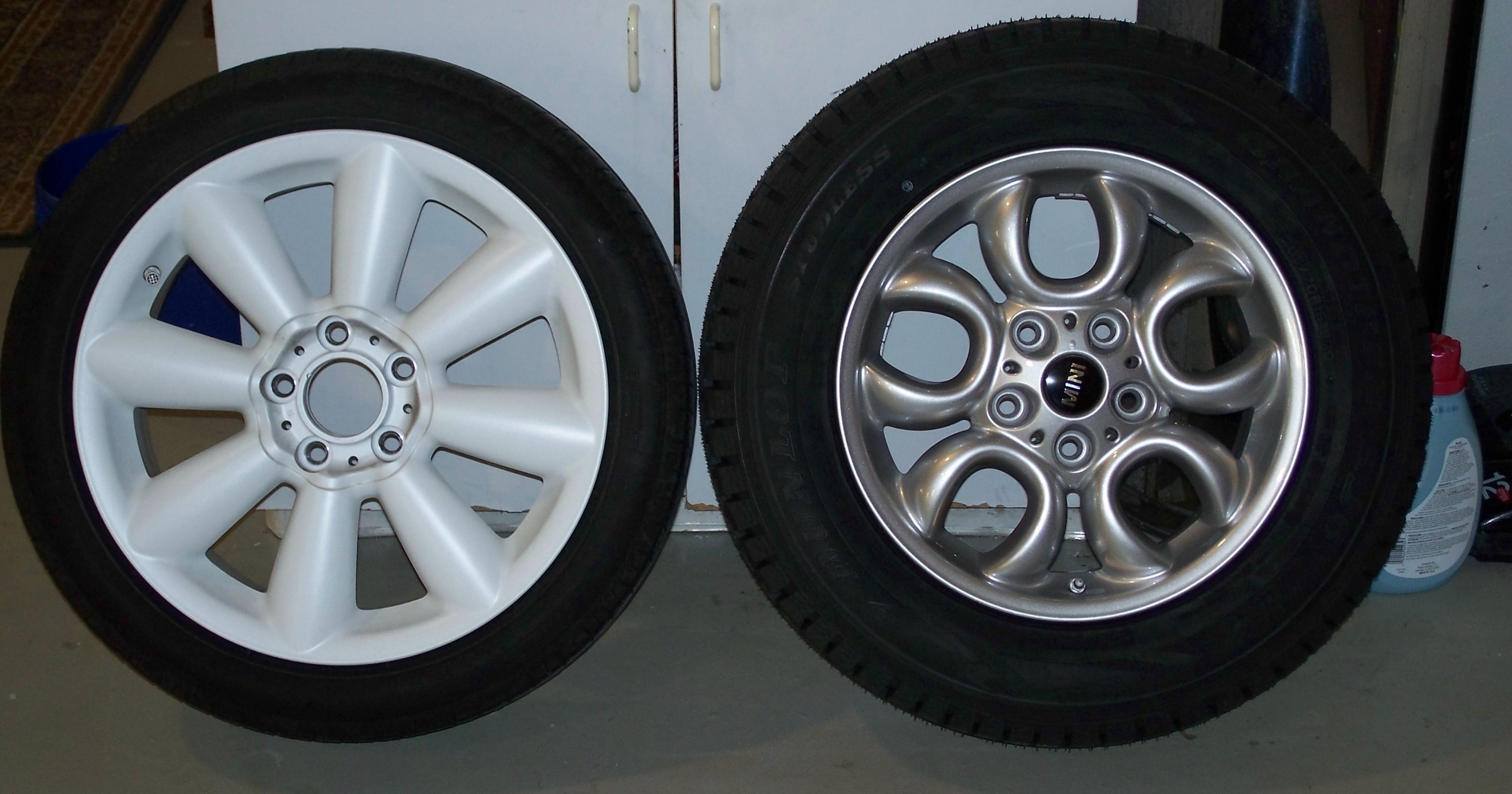

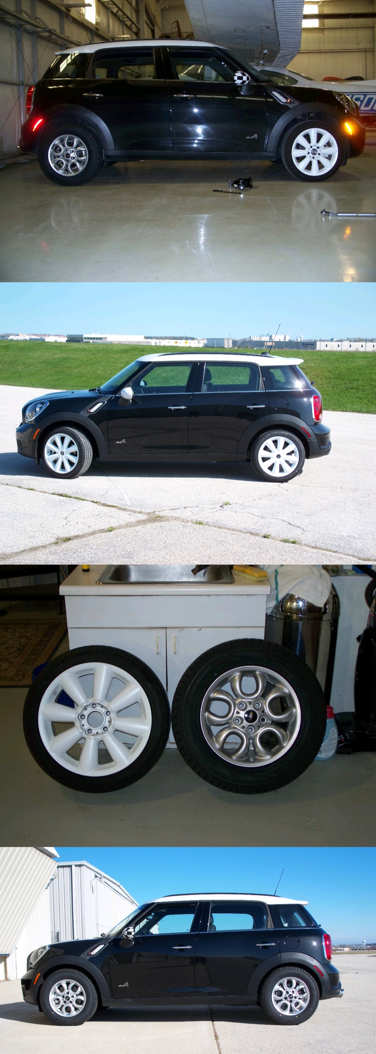

I am running 205/70R16 winter tires on mini oem 16x6.5 et 46 alloy wheels as fitted to R60 One model in europe. The white wheels are the stock 18x7.5 et 52 wheels with 225/45R18. The silver wheels are the 16s.

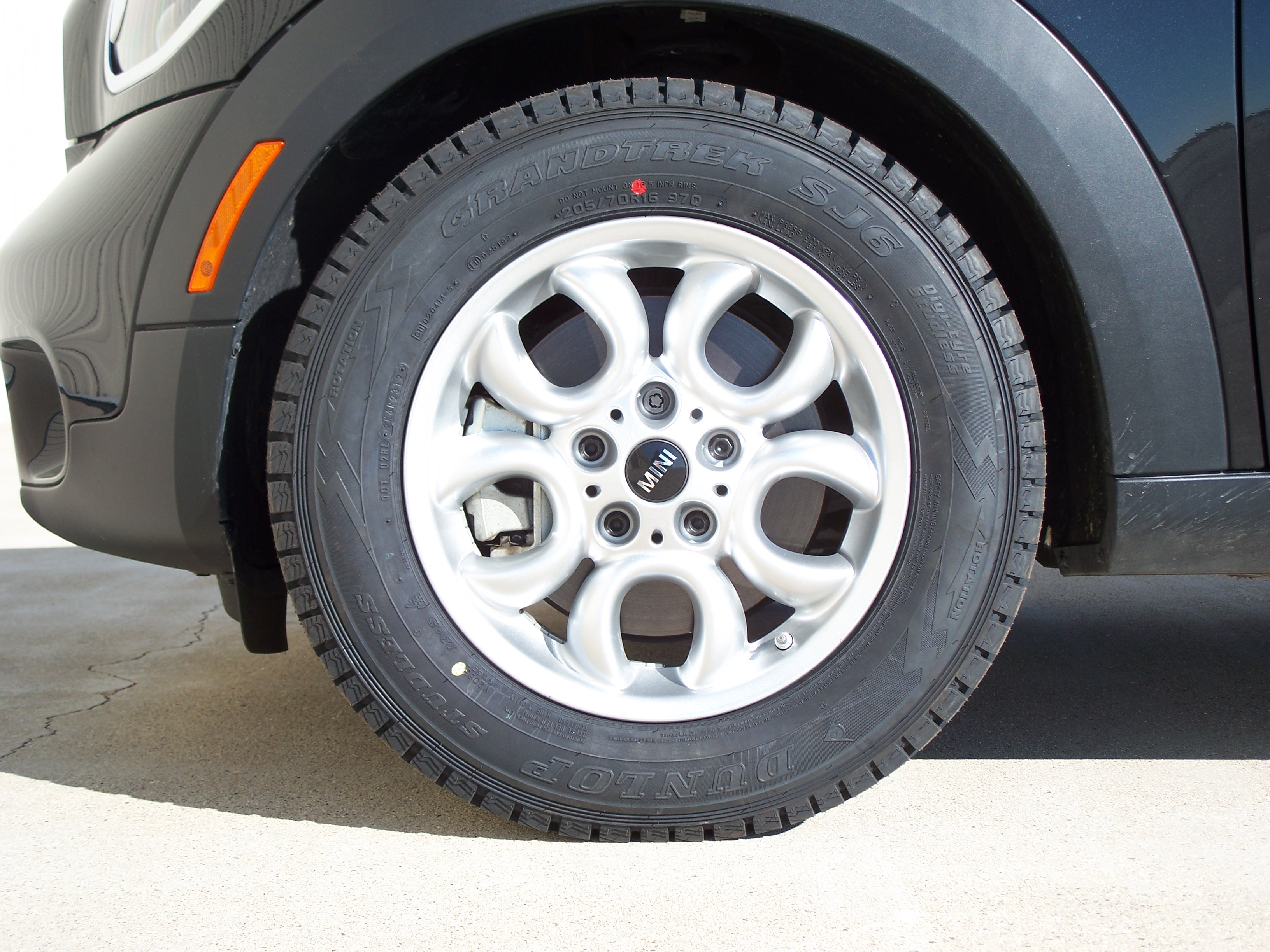

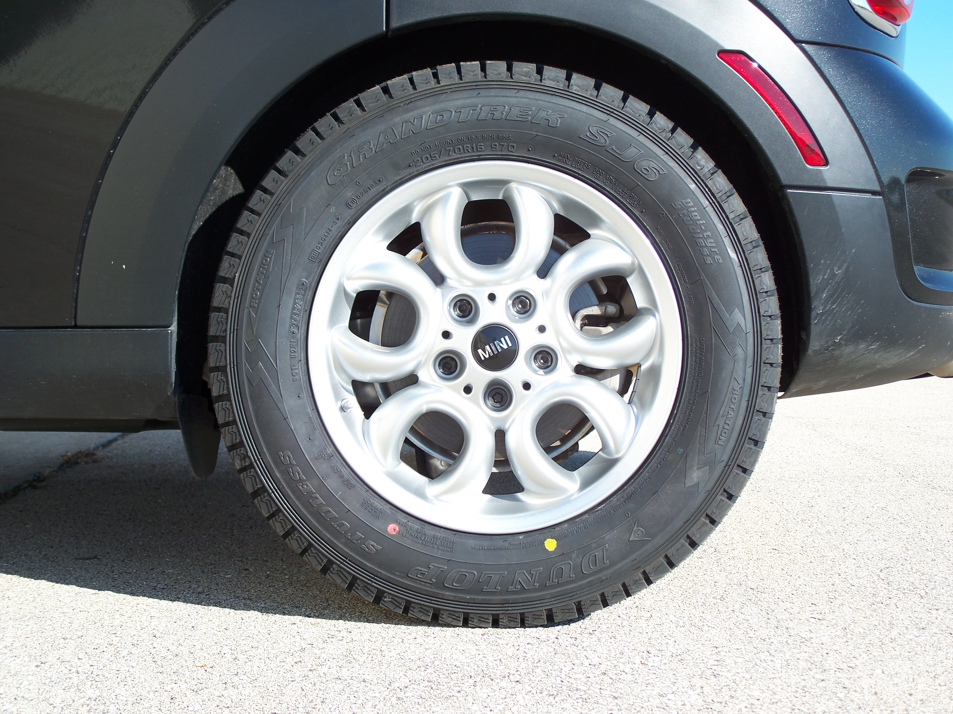

I went with the 16 inch mini oem alloys from ecstuning. I bought them in 2012 along with the dunlop grand trek sj6 studless ice and snow tires 205/70R16.
I got 6 winters out of the tires, just got my second set last month.
