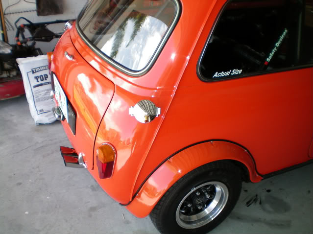

10 inch . . .
sometimes smaller IS better
