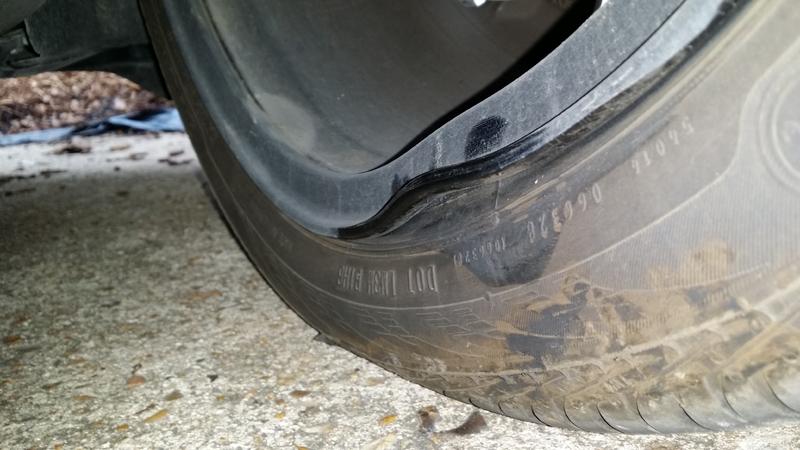

Here's the damage. I didn't want to believe it, but I finally found it.
Am I the only one with this kind of luck? Not even 1500 miles on it yet.
Attached Thumbnails 4 lugs? 5 lugs? Flip a coin or what?-20150521_191251.jpg
Old May 22, 2015 | 05:14 AM
Posts: 36,760
Likes: 2,549
Ouch, that stinks.
Some repair places will do it if the wheel is not cracked. But if the repair cost more then a new wheel then you have the wheels linked above.
