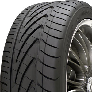

Had my tires installed today! Process was easy with no add-ons or up-charges offered and I was in-and-out within the hour.
The ride has completely changed and I am completely in love. I'm taking it easy for now, but I'm carving the road like a hot knife through butter. Only thing left is to give the wheels a good wash, but it's raining all week, so that will have to wait for now.
Thank you guys for all the input and feedback throughout this process and special thanks to
-=gRay rAvEn=- for recommending the Nitto NeoGens!
