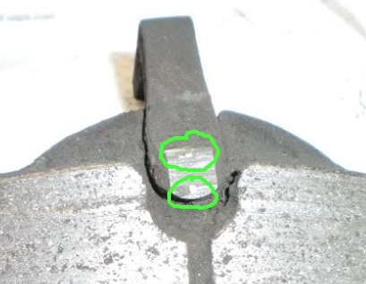

sensor must be 'replaced' if tripped to clear the indicator light (or by-passed). In theory sensor can be reused if not tripped (it works by being 'consumed') but getting one out of a used pad can be a problem as they get brittle over time due to heat. Typically only one has tripped .... there is one left front and one right rear. Here's a consumed sensor still in the pad ... the plastic is worn down and you can see the stubs of the wire loop which was broken to 'trip' the sensor

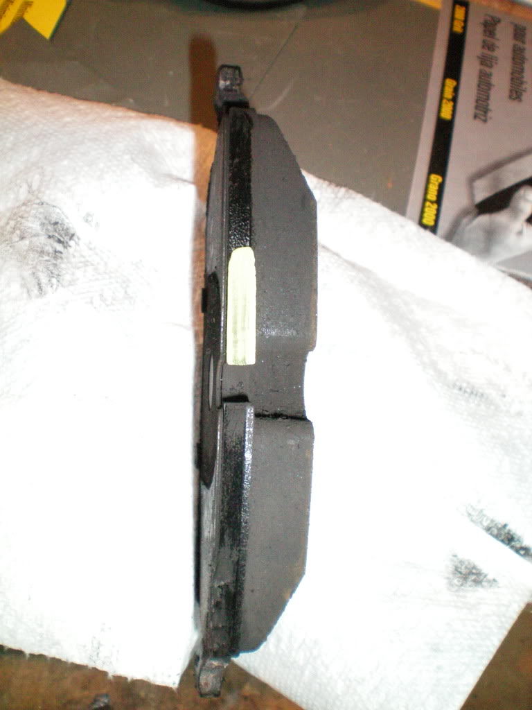

Rule of thumb on pad wear is when pad material is thinner than the backing plate it is time to be thinking about it. Used pad with white flash on backing plate

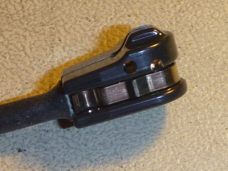

Yep, the brake wear sensors do kinda weld themselves into the recess in the backing plate. I swapped my first brakes (to go from Cooper to S brakes) at under 10,000 miles and the (un-triggered) sensor did come out - but it lost the metal clip that holds it in the pad recess, so then it wouldn't stay in the new pads!
Some you win, but most you lose...
