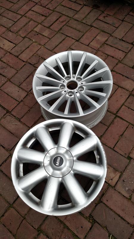

Originally Posted by JAB 67
I just went to the BAVAUTO.com website. Wheel refurb product description says "Silver paint matches BMW wheels best. For MINI wheels, compare color to BMW silver wheels before ordering." Anyone actually do this? The wheels I want to repair are S-Lites. I assume they are the same silver as BMW silver, but I don't know.
To my artistically challenged eye, the colors look the same between the BMW and MINI wheels in the pic below (the clean parts).
