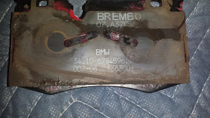

checked all the torques, still did it. took a closer look at the pads in the caliper, and I apparently missed the "step" where you move the stock pad shim off the OEM pad and put it on the HAWK pad (see picture), it was my first brembo brake change to non-oem pads.
Tomorrow I clean up the shims and move them over, looks like it could help
