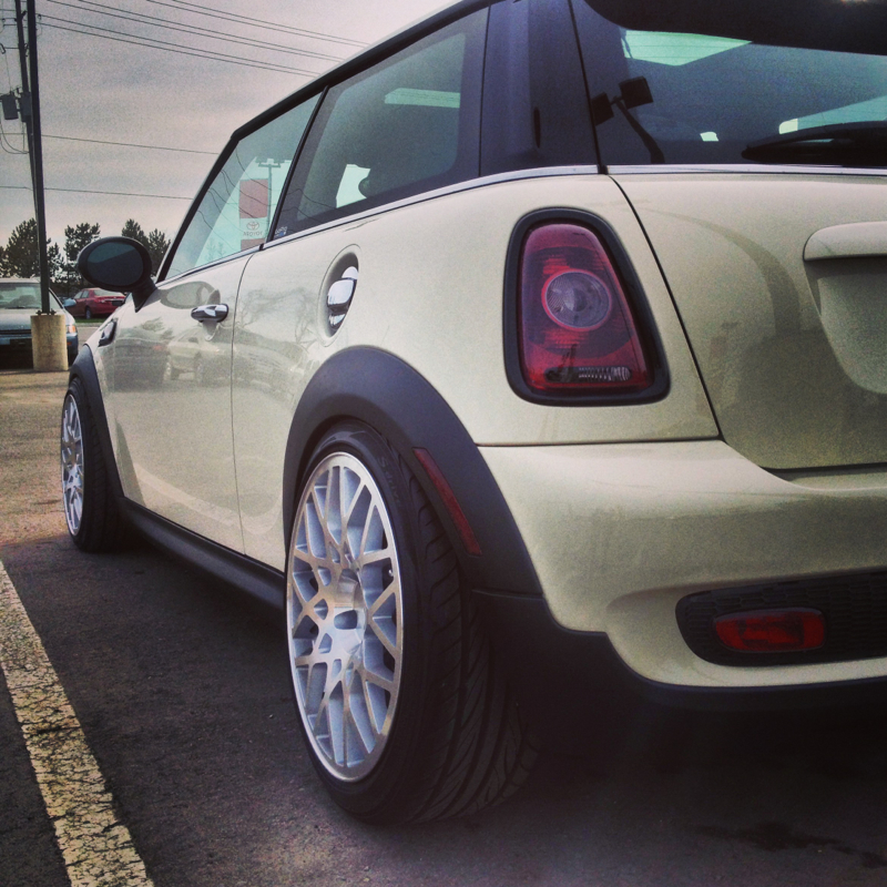

I use 205/40/17 General G-Max AS-03 on 17x8s et25
EDIT: for the record, I had 215/40/17 Continental ExtremeContact DW on my 17x7.5s and that is one incredible tire. The wet traction is so good the road doesn't even feel wet, and the dry traction is just plain ridonkulous. I will definitely use them again when I get dedicated summer wheels.

I have the TD pro race 1.2 in 17x8 and run the kdw2 235/40-17 and it is my daily driver which is why the rivals where out as an option I need more than a 200 tread wear rating one reason I never bought the Pirelli run flats I have run Michelin in the past but they wear funny on the MINI mainly cupping.

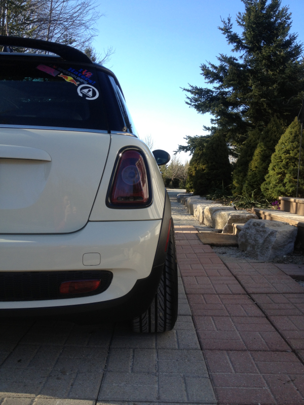

Thanks for all the comments for far. After pondering all the points above, I think I've decided: 17x7.5 Team Dynamics Pro Race 1.2 with the BFG Rival in 215/45-17. I figure the 7.5 inch width addresses my desire to have a slightly wider than 7 inch wheel, and might also allow me to better take advantage of the 215 series tire. It looks like the 17x7.5 version of the TD PR 1.2 may weigh less than the 17x8 size, so the penalty hopefully isn't as large as the 17x8 size. (I say maybe, as I'm not sure the weights listed correspond to the MINI fitment specs...) There should also be less issues getting it to fit on an R53 vs. the 8 inch wide version.
FYI, here's a picture I found to someone running this wheel in the past (et42) -- I love the look (although it is an R56...:-). Not sure what tire size he's running, but I'm guessing it's lower profile than the 215/45 size.
