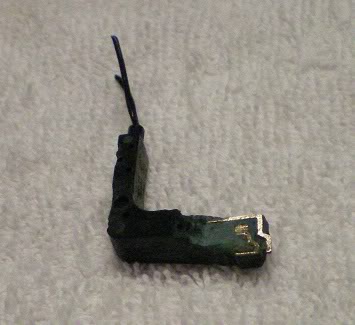

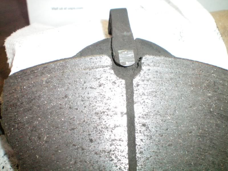

I've dissected a worn sensor and fail to see the circuitry mentioned RE the gen2 sensors ... perhaps I need to dissect a virgin?
or all the more reason to by-pass them all together . . .
(this sensor is off my 07 which I changed out to EBC green pads about a week after they became available.)
First time my brake warning came on I visually inspected my brakes and reset the 'counter' cuz I had plenty of pad left ... lite went out
I drove another several thousand miles and the lite came back on (counter or sensor?) .. and decided it was 'time' so I replaced the pads. Which WERE still serviceable. I reset the counters (again) and jumpered out the sensors (and went thru the reset) the car was happy . . .
This entire brake sensor thing on the GEN2 has never REALLY been explained IMO. Lots of "I think" and "I saw" ... all I can say is what I have experienced working on my cars and those of a few folks who come to me for (free) service.
