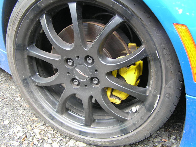

Post of photo of your front wheel, so we can see what wheel and brakes you have.

Hope this loads.

Those are the stock R56 (Gen 2 MCS) brakes painted yellow. They are the same as the JCW brakes on the R53 (Gen 1 MCS). The R56 JCW brakes are larger 4-piston calipers and larger rotors.

So... is this going to keep me from being able to use a 16 inch rim? I was looking at the 195/55-16 as a replacement for the 205/40-18 I have now.
Old Sep 22, 2011 | 07:19 PM
MaverickGun's Avatar
MaverickGun
Joined: Apr 2010
Posts: 181
That should be fine.
Old Sep 22, 2011 | 07:27 PM
wandrur's Avatar
wandrur
Moderator
Joined: Jul 2008
Posts: 11,899
From: Fredericksburg, VA
As long as those are the regular S brakes, 16s will work fine (that's the stock rim size for the R56).
