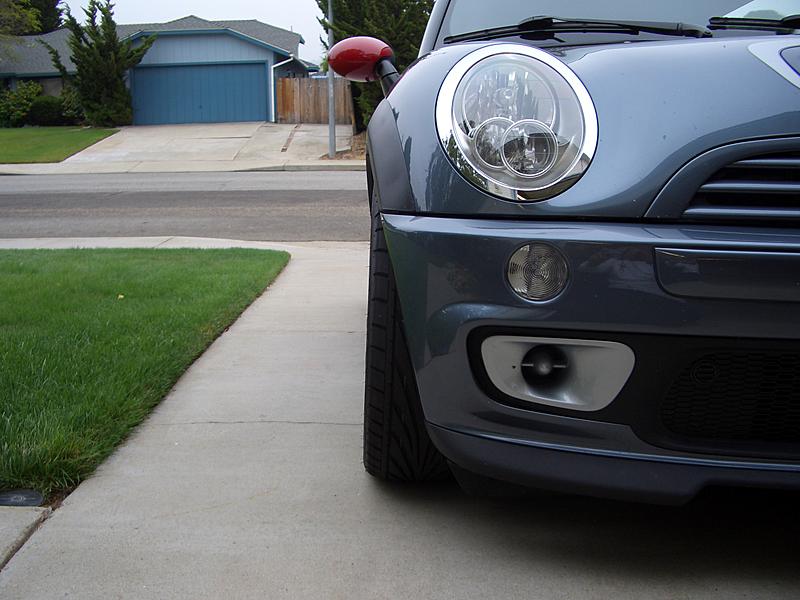

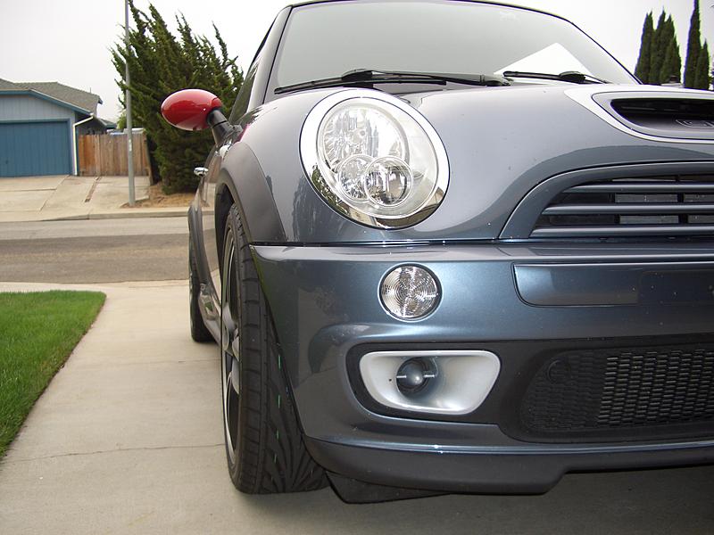

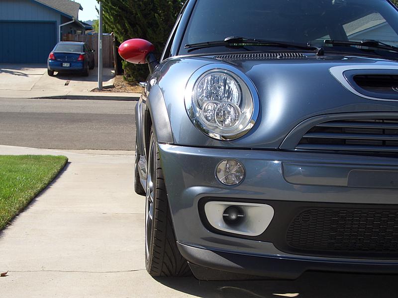

Attached are pictures.
1. Front view with 15mm spacers
2. Front slight angle view without spacers.
3. Front slight angle view with 15mm spacers.
You can even go with 20mm spacers in the front with no rubbing issues.
It is hard to tell from the pictures but I think it looks much better with the spacers.
