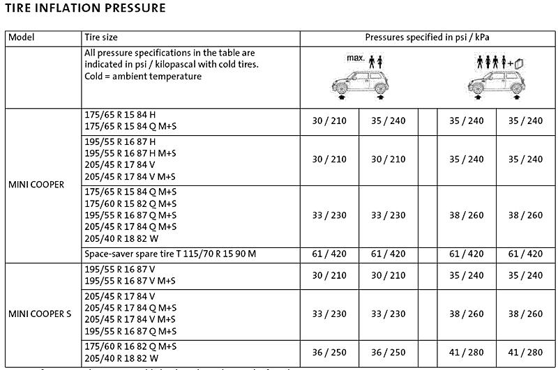

Attached is the complete tire pressure chart from my `05 S Owner's manual.
Note that 38 lbs. is recommended only if you have four people and their luggage on-board. I run 34f/34r on my 205x50x16 non-RFT, for VERY active hairpin roads. Note that 38 lbs. is recommended only if you have four people and their luggage on-board.
On a 2700 lb. MINI, 38 lbs. certainly going to feel overinflated with just a driver, as it is 3-4 lbs. too high for decent adhesion. The only reason for running that high a pressure on a 17" tire is to keep the rims off the potholes, and the struts from mushrooming the strut-towers, since you don't have enough sidewall to protect them with a full load.
That is what I would have thought - but the door label says 38 for 17" tires even when not fully loaded. 90% of the time, it is just me in the car, and it does feel pretty hoppy at 38 PSI. I'm tempted to cut it down some and see how it rides...

You said this is from an '05 manual but the OP is talking about an '08. The '08 manual does state 38 psi for regular use.
I have my set at 38, sure the ride is a little stiff but it is what it is, and I will follow the recommended tire pressure for my own piece of mind.

The `08 uses the same wheel and tire sizes as 1st-gen. cars, and the `07-`08 are even lighter than 1st gen. MINIs.
If I were MINI, I'd raise the recommended pressures too, to keep the warranty claims down (at the expense of ride and handling).
