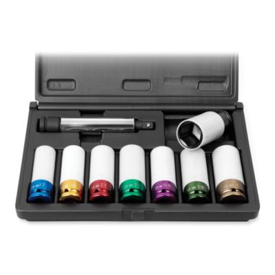

or
These are bit expensive but you may be able to find just a 17mm at your local car parts store.
from griots garage.

You know I will be careful... but the dealer mechanics are pressed for time, I doubt they will be as careful. Those sockets from griots are sweet, I will look around for them. Thanks.

I use the Griot's set. Yes, not cheap, but I couldn't find an identical quality elsewhere, so I bit the bullet. Definitely worth it, very easy to use. I have the stud conversion. Everyone who has seen this set of protected wheel drivers loves it.
Yup, hand tools only. I have an air compressor, but I don't use it on the Mini.

SYCO, thanks for the pics and recommendation... the Griot's set looks like it is really well made. On a side note, you should take a minute to clean up your garage, it's a mess
