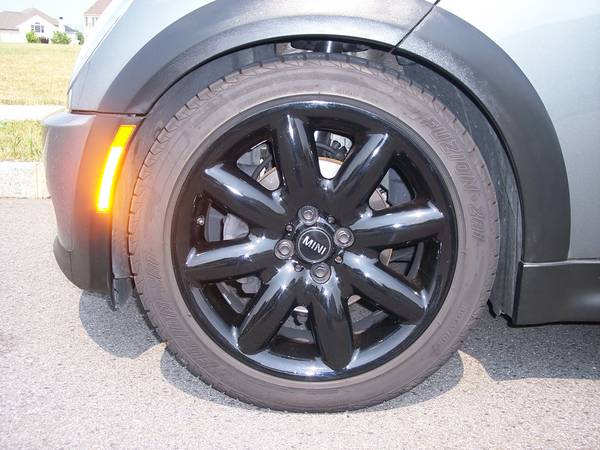

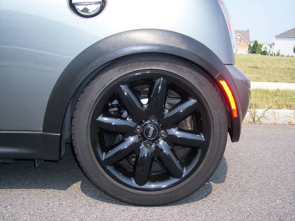

Well, just do it right......Most lowered MINI's look like crap because they drop the back too far. Just keep the wheel well gaps consistent! and it will look sharp, if not it just looks like an hack job......here is a good example of what NOT to do. Unfortunately the galleries are full of bad lowering jobs
Attached Thumbnails when lowering a car should it be slightly higher at the front?-15265100_0097.jpg   when lowering a car should it be slightly higher at the front?-15265100_0099.jpg   when lowering a car should it be slightly higher at the front?-15265100_0101.jpg

you can't use consistent wheel gap for proper lowering since the rear wheel well is cut a bit lower... your car must look like a hack job too then...
lets be honest, very few set up a car specifically for performance only; most are looking for some kind of compromise between performance and looks, and looks for sure are a personal thing, like an opinion... like your comment...
how do you control the drop of lowering springs?
one would have to cut springs to control the height (not recommended btw) unless they have coilovers. coilovers are controllable in height but not springs alone...
most cars in the gallery that are lowered have purchased springs specifically for the MINI. i have yet to see any lowering springs on the market that lower the front end tighter than the rear.

The picture you posted looked like the car was dropped on springs. Correct me if I'm wrong. My car is dropped on H-sport springs and they drop the car an inch front and back so my car as well as most on springs look much the same. The front of the mini has a bigger wheel arch opening than the rears which would make it look like the back is droped more then the front. I believe that people with coilovers can correct that "look" but I don't think it would make the car perform better so it would only be for looks. I think most Mini owners want performance a bit over looks (not all) and I know I'm very happy with the performance of my springs and I'm very happy with the look.

Mine looks pretty much the same as yours but my front is a tad lower.I can get 1 finger between the front tyre and arch and abot 1 1/2 at the rear.
My front end of my side skirt mesures 10.5cm and my rear mesures 14.5 cm

If you have H-sport springs with 18 inch wheels with 215/35/18 tires then the difference in gap would come from tire differences most likely.
im not going any lower and will fully test the handleing this weekend.
