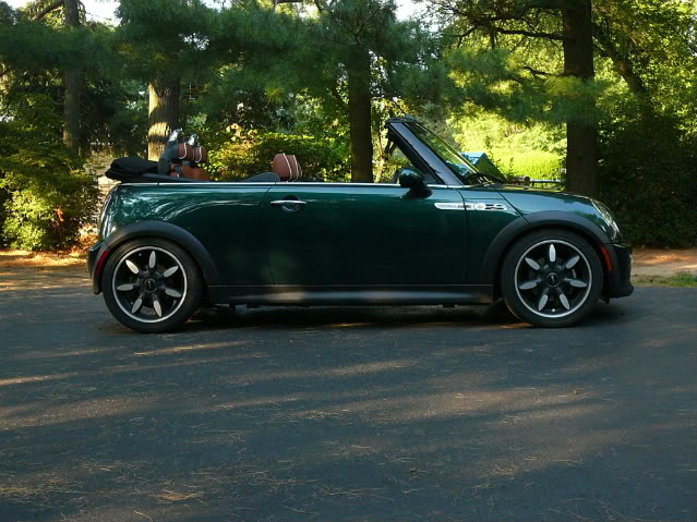

here she is, 1 inch lower all around. alignment this monday. i'm already very happy....can't wait to see what getting rid of some of that negative camber in the rear is gonna do

Well I guess I'll be the first one. Looks real nice Ox! But doesn't the rear seem higher than the front. Is that just expected or can the front not go any lower? Thanks man and again...looks great

i kept the same rear/front height difference as stock....so yes, the rear is about 7/8th's higher than the front. i didn't want to stray from the factory design...i thought it might introduce some undesired characteristics. but you can see that the rear "gap" is gone....i didn't want to lower it any further (i have another 1/2 inch i could drop if i really wanted to tuck it). just as others have said, i suspect i could lower the front about another 3/8".
i also think the slight "uphill" perspective i used on the pic might have something to do with it.
