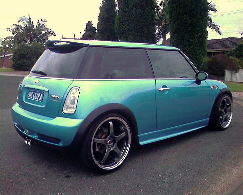

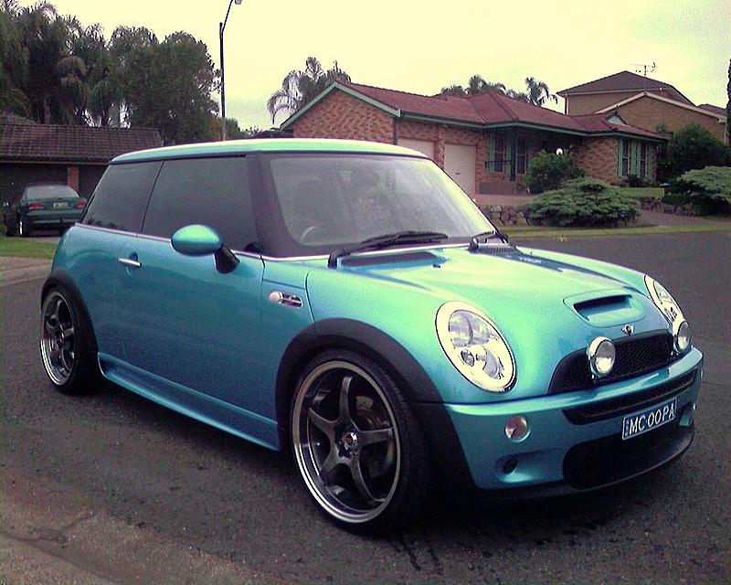

Fitted my BC's last weekend, very happy with the ride quality & camber increase & the handling is incredible.
Attached Thumbnails BC coilovers installed (how-to & feedback)-mcs-2-.jpg   BC coilovers installed (how-to & feedback)-mcs.jpg   BC coilovers installed (how-to & feedback)-mcs-3-.jpg
which springs did you fit, 8kg forward and 6 rear or 6 kg on both axles?
nice ride bro'
hey cliff and cor blmy, i'm not sure if it was mentioned earier or not, but please endulge me. do i need new rear control arms if i get these coilovers? i'm likely gonna join the club in two weeks. thanks for the great info
