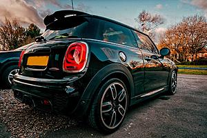

Hello all,
I've just bought an F56 JCW as a daily driver, and the first mod I want to do is to reduce the enormous amount of wheel gap the car has!
Car is 100% road car only - I've got my old R53 for track use
I've seen a few images of cars dropped on H&R springs, which seems like the ideal ride height for me - but I also read that these springs are too low for the stock dampers and it runs on the bump stops all the time?
Is that correct?
I notice that the Eibach ones only lower by about 15mm, whereas H&R are 30-35mm?
Any users of H&R springs able to comment?
Thank you
