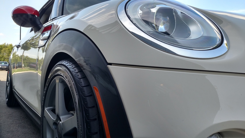

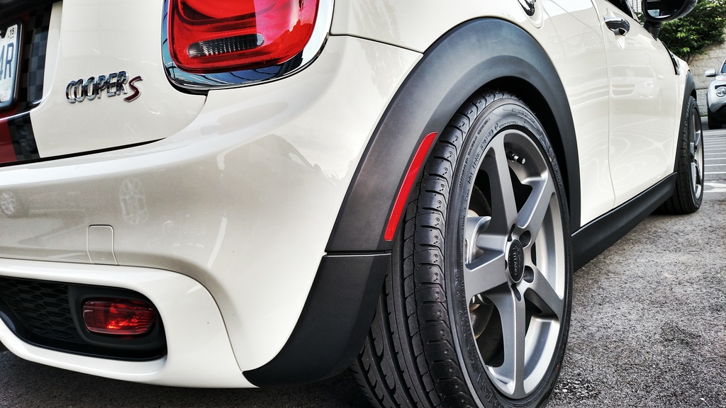

Posts: 472
Received 4 Likes on 4 Posts
NM springs and 22mm sway.
