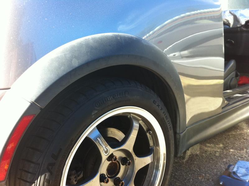

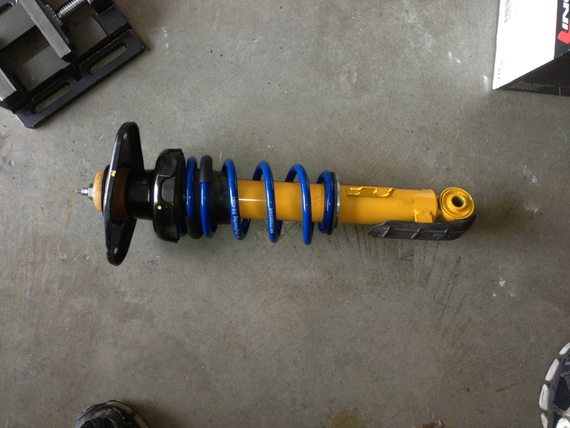

so i tackled the suspension today. did the rear first because i needed to do the rear sway bar as well...
going along welll.... put the konis on using oem parts ... drilled out top hat and washer.....
Im positive I put back all the parts exactly the same as oem plus the koni hardware.
everything went well.... went to drop the car
and then the rear is HIGH.... i want to says its stock height...
I dont know where I could of screwed up... its really high
havent tackled the front.... cause i was tired hah
the only think I can think of that I may of screwed up was how i bolt up the upper portion the 2 13mm bolts... the top hat is slanted... but i figured there was only one way to mount it.. slanted so that the lower bolt can be mounted......
is it even possible to mount it wrong?
im seeing the stars from the heat... but let me remember i put the hardware together....
starting from the bottom:lower rubber isolator, plastic washer bottom of shaft, bumpstop, washer that goes on the snap ring, then the upper rubber isolator/dustboot, then the drilled out tophat, then upper mount with foam, the little foam that goes on top of upper mount, drilled out washer, then lock washer, then koni nut... all torqued down...
i cant measure but i fit 4 finger in the rear gap... i know swifts only lower 1/2 inch in the rear... but i figure it at least noticeable
ive seen people's pic of swifts and they are def lower....
please help... i didnt want to test drive.... thinking i royally screwed up lol

Tell us what size wheels and tires you have mounted. Then measure the vertical distance from ground to fender lip (through the center of the wheel hub). Keep in mind that you need to drive the car some before the suspension will settle to ride height.
Old Aug 25, 2013 | 06:40 PM
vietnameeh's Avatar
vietnameeh
Joined: May 2012
Posts: 378
16 x 7.5, 205/50 16
driver side 25 3/4"
passenger 25 1/2" (driveway probably not level)
how does it sound... i feel like i installed it right... i have installed many many suspension... i was just dumfounded haha
ill drive the car some once i get the fronts on

The Swifts don't really settle like other springs. Have you driven on them yet? Sometimes the back end looks really high with the parking brakes set.
Old Aug 25, 2013 | 09:06 PM
vietnameeh's Avatar
vietnameeh
Joined: May 2012
Posts: 378
I think im going to have to dirve on them i want to put them fronts on first... then ill take a drive hopefully everything stays on lol
Old Aug 25, 2013 | 09:08 PM
davisflyer's Avatar
davisflyer
Joined: Aug 2005
Posts: 2,097
From: Knoxville, TN
Just drive around the block and park on a level spot with car in neutral and parking brake off and see if it looks better in the rear.

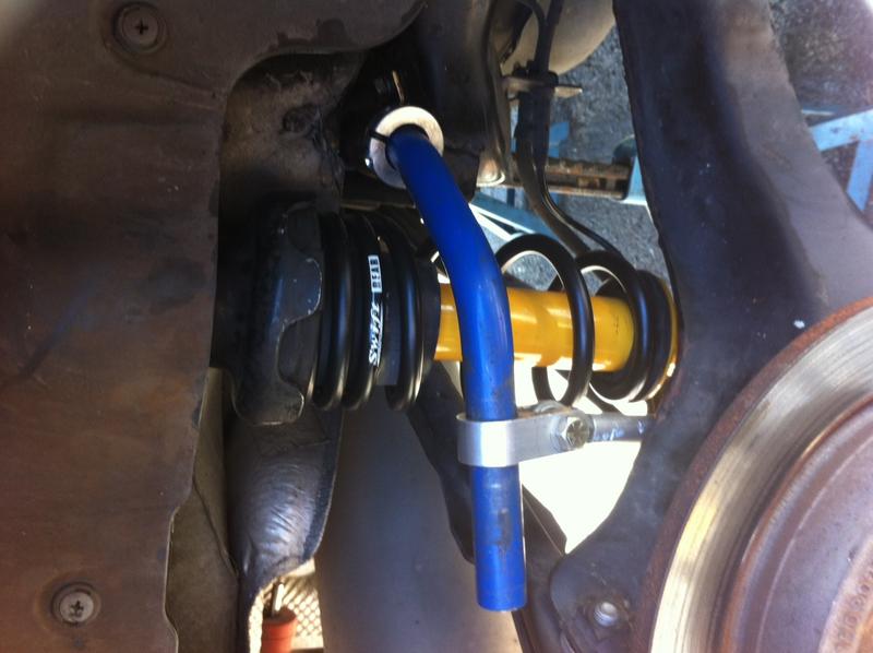

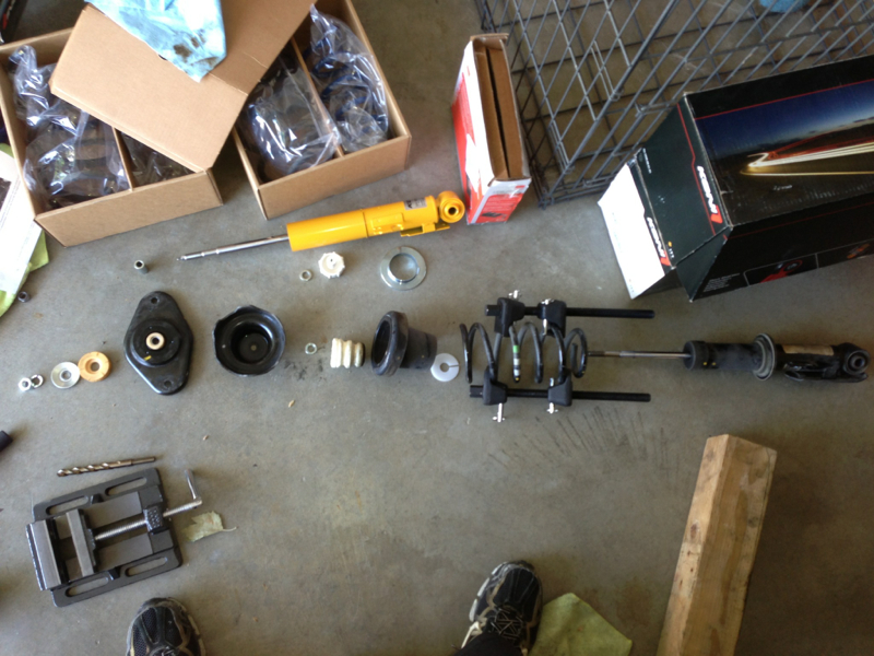

This isn't the best pic, but this is the order I reassembled the strut/spring with the nm springs. Hope it helps.
Attached Thumbnails urgent where did i screw up? koni/swift-image-3479540941.jpg   urgent where did i screw up? koni/swift-image-3452910132.jpg
Old Aug 25, 2013 | 09:36 PM
vietnameeh's Avatar
vietnameeh
Joined: May 2012
Posts: 378
ok perfect. thats exactly how i did that.
