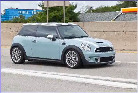

Here's my 2012 MCS with 35,000 miles on NM springs...two adults aboard, 205/45-17s.
(screen capture from the MINI on the Mac video 8.3.2013)

shoudl have said this would be for a r53 ..... but that is the look i'm going for ljmattox
