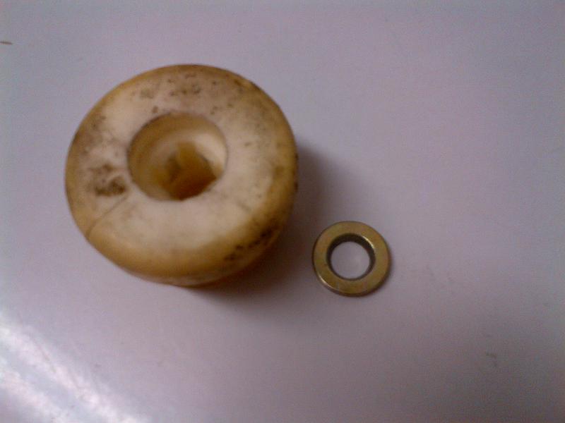

Here is the oem bumpstop and washer that fits into it. I had originally assumed that the the bumpstop would go on wider side up and the little washer would make contact with that small ring on the shaft of the konis. It just made a lot of sense to me from looking at it. However, the more and more I look at it, I begin to think that the wider end of the bumpstop is supposed to face downwards as it is the cleanest part. That has me thinking it is installed from the factory pressed up against the shock body. If thats the case, the little washer looks like something I could probably get away with not using.
Honestly I never thought these struts would give me such a headache! Koni gives the absolute worst instructions and the best install guide I could find (pelican) was for Bilstein Sports, which I assumed would be a very similar/identical procedure to the Konis.
Thanks for all the help everyone. I just hope its worth it when I get them set up properly!

I already have the koni supplied washer sitting as pictured in figure 9 of these instructions. Is that the part that replaces the oem washer? So I should just throw on the bumpstop on as pictured in that guide (larger side up) and I'm good to go???!

Well good news everyone! I took everything apart, added the bumpstops and replaced the nylon washer with the oem one I drilled out. Made sure everything was tightened and now there are no noises!
