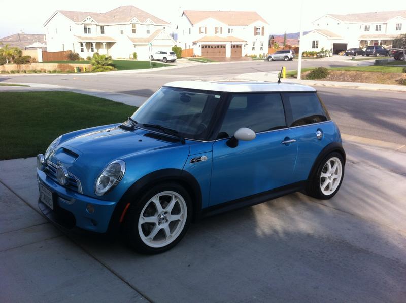

When I first bought my '02 it had H&R springs on stock shocks with 215 40s and a super tight, but harsh ride - wife not happy. Then I installed Koni yellows with the same H&R springs and the same tires. Not quite as harsh and a pinky finger higher ride hight - wife couldn't really tell, still not happy. Now I have 215 45s and the other mods - wife won't let me drive
I really love the mix of supple yet sporty ride - no loss of performance and a big gain in comfort.

Nice ride!
I have the exact same colour combination.
Thank god I don't have that problem since I got her a car that she can drive so I can drive my mini (she doesn't drive manual).
How's the height of your Koni Yellows + H&R setup? Preferably, I would only be looking for a 1" drop. Which is why I'm a bit weary to look at spring/shock combos since I have won't have much control over the drops
