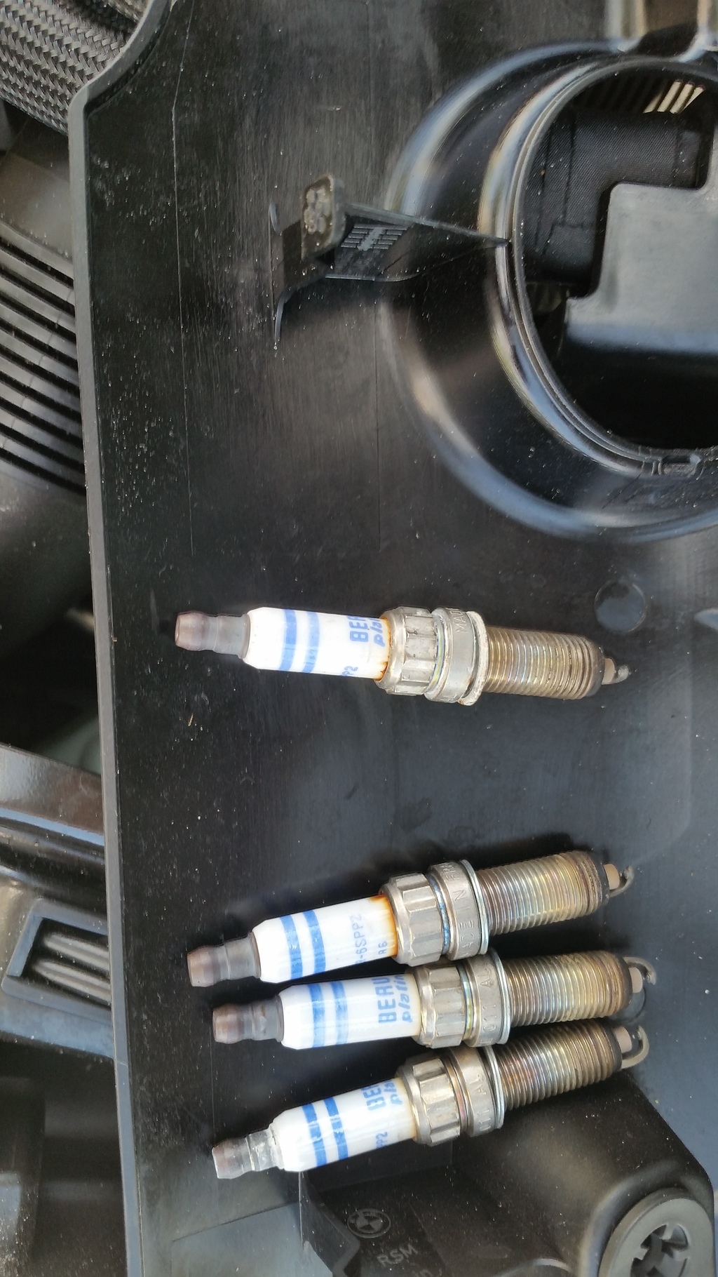

Got the right socket pulled all the plugs. All of the plugs didn't look so good for only having 40,000 miles on them. Cylinders 1 & 2 had a little bit of rust at the base where the porcelain meets the Aluminum(?). I moved all the plugs around and all of the coils around, started it up and had multiple cylinder misfire code p0300
It looks like the previous owner also had some issues as three of the coils were Delphi and the 4th one looks to be the OEM (cyl 1)
Not to just throw parts at it, but sounds to me like you might need to just change them out. I'd maybe start there. If that's what you decide to do, the Beru plugs here have a 10% discount if you put COOPER in at check out. Coils here. It is weird that 3 are changed and one wasn't, but maybe the issue he/she had was resolved for them with the replacement of 3 coils and not the 4th? We have a DIY here, look at figure 5 as it shows what a plug with 30,000 miles on it looks like.
Fig 5 is exactly what I would expect them to look like...
I'll start with the plugs ....if needed I'll pro b ably just buy 4 new coils

First, major props to this man...ordered last night parts at my door by 11am had I known they were coming so early I would have bailed out of work
Car definitely needed plugs, I couldn't even troubleshoot the coils with the old plugs. Swapped them out started it, unplugged coils while car was running one by one. Found dead cylinder, swapped coil with another started it back up and repeat, isolated it down to a single coil. Gotta run around all day tomorrow for work by atleast two dealerships I'm going to try n find one local tomorrow just to get it back on the road before weekend. My other car sux.
