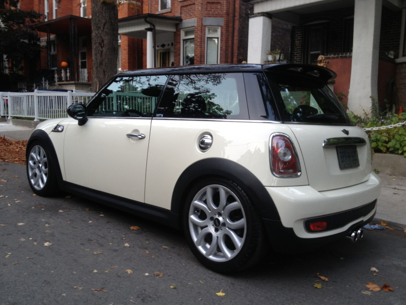

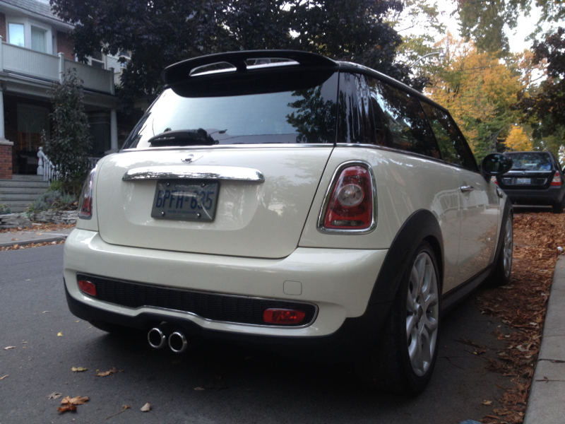

Here are some pics! I might be putting it back to stock. I am really pissed at the vibrations in the driveshaft.
Attached Thumbnails Coils goong on soon!-image-762345008.jpg   Coils goong on soon!-image-1048298519.jpg   Coils goong on soon!-image-1647161193.jpg
Damn that sucks, sounds like you went too low.

How much was your drop after lowering? About 1 1/2"?

Car looks really nice...Sorry to hear about the vibration.
There is a thread that I was following about a year ago that discusses this problem in detail. While the gist of it is that it has to do with the drive shafts being too straight, it is also somewhat random. Is there room in the springs to raise the front to see if it goes away? You can also put spacers between the camber plates and the strut tower to raise the front. If that works, the back will need to be done too.
