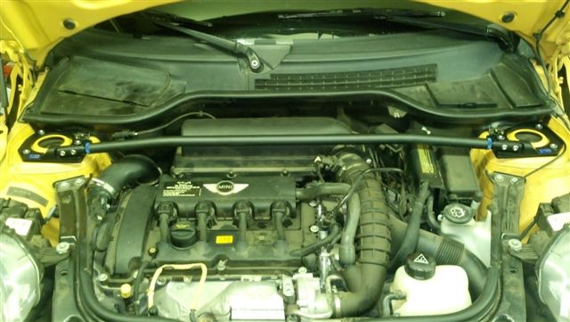

I just installed the NM Strut Brace. Quick and Easy. I have stock Air box, so that will be something to look into options for soon. But no clearance issue with stock Air Box.
Attached Thumbnails Fitment of Strut Brace and Intake Combo Reference-mini-strut-brace-07s.jpg

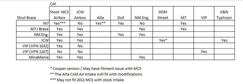

This is by no means complete but based on previos posts here is what I see so far for CAI / Strut brace fitment
Feel free to correct me if I'm wrong, or add as needed.
When I get a chance I will add part numbers for clarification.
Updated 5/16: Added VIP parts braces.
Attached Thumbnails Fitment of Strut Brace and Intake Combo Reference-image1.jpg
Last edited by speedkills66; May 16, 2012 at 06:36 AM. Reason: Updated attachment - Added VIP parts

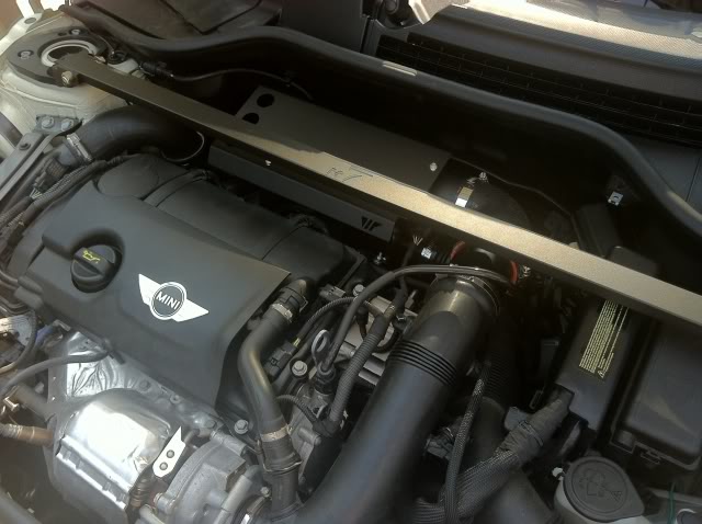

Agreed; I had to remove some padding from the bottom side of the hood, and slice the rubber surround where the bar overlaps it, (optional). You can see in the picture below, (especially since the m7 bar was powder coated red), where the black rubber surround of the Alta box runs into the red bar, seemingly stops, then continues on the other side. The rubber surround still actually continues on underneath the bar. After slicing the top part of the rubber surround, the bar then squishes that surround down, for perhaps a nicer look.
