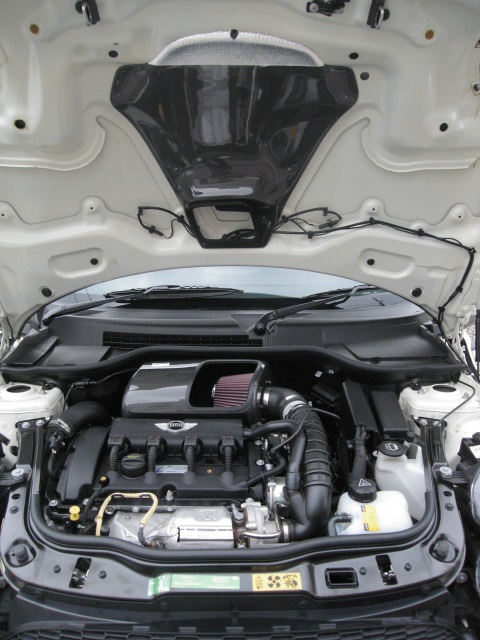

Does anybody know if there is a strut bar that fits with no rubbing for RAM AIR type intakes? Im talking about the ones that have the mounted air duct underneath the hood scoop like DDM, AEM, and RD makes. See the pics for what I mean. Is anything available that wont block this set up? Im trying to find out what kind of strut bar is in the first picture.
