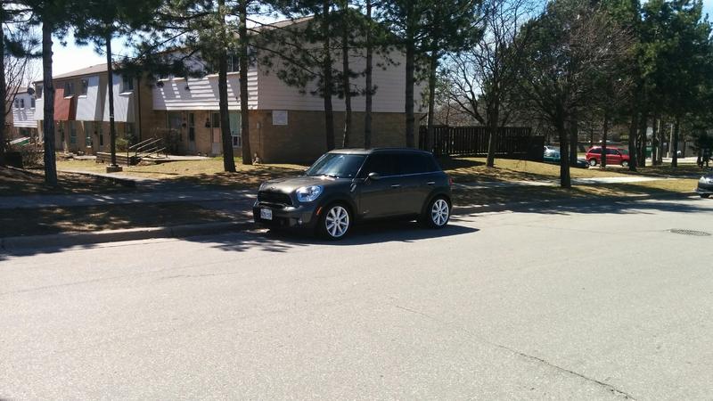

Just lowered my countryman with NM springs with stock sport suspension. Loving it so far!
Attached Thumbnails NM lowering springs = good stuff-img_20150415_171656.jpg   NM lowering springs = good stuff-img_20150415_121527.jpg
