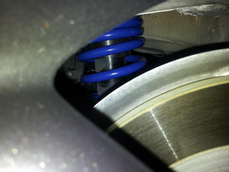

So Im getting quite tired of the bounciness of the NM springs, especially in the rear. Ive gone as far as ditching the runflat tires and getting an alignment to NM's specs, still no help, the car is rough as hell.
I took a look at the springs with the car on the ground, and not sure if I like what I see. I know the top portion of the spring is at a different rate than the rest, but with the mini sitting on the ground, with noone in the car, is the top part of the spring SUPPOSED to be completely compressed? This is a bit disheartening!
There is no way this is normal, shouldnt the top part be providning more dampening???
Can anyone else that has the NM springs post pics? Are these installed wrong? What gives?

I posted previously that they missed the boat on their progressive rate spring in the rear, and that photo obviously proves it. They need to go back to the drawing board and make a linear rate rear spring.

Can someone else post a pic of their rear springs? Someone with a NM suspension?

after work, I'll get on my back under the car to get a better shot. The progressive part does seem more compressed than I thought it would be. Also, I ordered the 2WD version from Way, but what came from NM was a box that apparently shows there is one model spring for both?
Attached Thumbnails NM lowering springs = good stuff-2012-10-10-07.06.06.jpg   NM lowering springs = good stuff-2012-10-10-07.00.38.jpg

how long ago did you get them installed? Have you had 4 people in your car? Its unacceptably bouncy with 4 people in the car.
Couple days ago my brother was asleep in the back seat while I was on the fwy, he's about 200 lbs. Every time I hit a dip on the fwy, I looked in the rear view mirror and I could see him bouncing out of his seat!
I contacted NM about this, in short they said our shocks are too soft and because of this we get the bounciness. He said they are working with Bilstien on a kit.
While Im happy they responded, it does nothing to address this issue for me, after buying springs, control arms, new tires and paying all that labor, the car rides like crap. I really wish I'd known this before I pulled the trigger.

Ive emailed NM asking them what good their progressive rate spring is when the top part is bound, waiting to hear back exactly what they have to say
As for now, I'm pretty sure I'll be going back to stock. I'll miss the nice handling in the twisties and the better looks but really when none of my friends/family/wife want to ride with me in the mini, what good is it?
Too bad it took me springs + arms + tires + labor + alignment to figure out that NM springs are junk. Phhhh..

So I heard back from NM, they're saying the dead part of the spring is by design.. Here is their explanation:
Unfortunately, it is by design. The 'binding' is necessary to get the correct spring rate, we call it dead coils. This keeps the spring sitting firm on the shocks when the suspension is at full droop (on the lift, driveways, or slight airborne). And with the MINIs, you cannot have fully spread coils top to bottom with progressive rate (or stiffer rate for that matter) on the rear and lower the car at the same time too. Just physically impossible for MINI Cooper unfortunately. Even the OEM's springs are linear. :-( And to get the rate that we need, the springs need to have certain amount of coils.
It WILL improve with Shocks. We like KONIs, but with Countryman specific I think the Bilstein will work better.
