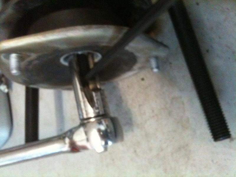

  • Since I did not have an impact gun, I had to remove the top strut nuts with regular wrenches. The oem struts use an allen key to keep the strut shaft from turning with the nut, the Konis use a conventional hex surface. If you can't keep the shaft from turning, you won't be able to remove the top nut. So, I had to make my own tool, by using an angle grinder to cut most of the face away from both a 21mm deep socket (for the oem) and a 19mm deep socket (for the Konis). With the open deep sockets, I could insert a 6mm allen wrench to hold the oem shaft steady while I used the socket to remove the nut. On the Konis, I used an 11mm (front) and 9mm (rear) box end while turning the nut with the socket. I've attached a couple of bad images, so you can see what I mean.
