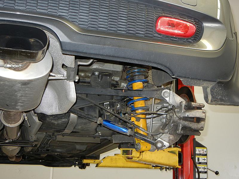

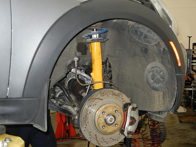

Koni Yellows + NM Springs = FUN!!
Put the Koni Sport/Yellow adjustable shocks on this AM to go with the NM springs already there. WOW!! Can't believe the all around improvement in handling. Front end squat and lift are gone, turn-in is spot on, no more "skip" when I hit a bump in a tight corner and even the Bott's Dots don't rattle my teeth as much. All this and no real change in ride quality, everything just feels "planted". Put them to their softest setting to start with. Probably the best way to describe the handling change is that when I pulled into my garage I just sat there and laughed for awhile! Here's a couple pics during install.
Attached Thumbnails Koni Yellows + NM Springs = FUN!!-dscn0134.jpg   Koni Yellows + NM Springs = FUN!!-dscn0136.jpg

Originally Posted by Bor
cool! thanks for the write-up !
could you please describe your whole suspension set-up ? I may go the same way (riding on TSW springs over stock shocks now...)
Hope you've got some time to kill cause I can talk about my MINI all day long, LOL! My goal at the start was to improve the all around handling of the MCS Sport suspension and still have a comfortable DD. I went with the NM RSa springs because of them being a progressive rate spring of very high quality. They lower the car 30mm (1.2") F/R. Just be sure to trim the bump stops to NM's specs! I also put on H-Sport's adjustable rear camber arms at the same time. If you don't you'll end up with about -2.5deg rear camber. Nice for track/AutoX, but hell on tires. After install I had the alignment re-set to OEM spec on the front, but did have the rear camber increased from the OEM of -1.5deg to a massive -1.7deg. I'm staying with that alignment as it works just fine for me.
I also have the H-Sport tubular 25.5mm RSB set at it's lowest stiffness. That bar has the same stiffness as a 22mm solid bar, is ~8lbs lighter and has zerk fittings on the bushing blocks. To stiffen up the suspension mounting points I put NM's STB and plates in front and RacDyn's CF STB in the rear.
To lower un-sprung weight I put on Konig Britelites. This cut 6.5lbs off each corner from the OEM Webs. I dumped the RFs long ago and now have on Michelin Pilot Sport A/S in 215/45 ZR17 set at 34psi. Not sure, but I think they're about 4lbs lighter then the RFs, stick like glue, are a great rain tire, don't track on any rain groves I've encountered and don't ride like they're made of cast iron. I'll gladly buy another set.
The above mods produced what others concider the best handling street MINI in my club, West Coast MINI. The handling is now dead neutral. The Koni Yellows were more then icing on the cake. I really didn't expect that big of an improvement after all the other mods I'd done, but I'll happily take it! The all around tautness of the handling still has me grinning, but the ride comfort is the really surprising part. These 67yr old bones don't tolerate hammering quite like they used to, LoL. Taking off on a +5K "test" run Sunday and am taking the adjustment **** along just in case. Rocky Mountains here I come!

Just finished my 5K "test" run and now I REALLY recommend the Koni Yellows!! They never bottomed out once and I drove on some truely abysmal roads. Settled on 1.5 turns for the fronts and zero turns on the rears and this seems to work just fine. They're worth every penny I paid and then some in my book!
