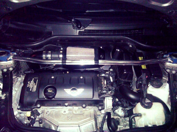

I purchased the GT Spec Front Strut Brace not too long ago. I had the Racing Dynamics unit, but when I put in the K&N Typhoon, the two wouldn't work together. Upon putting in the GT Spec, I had issues with the K&N inlet pipe rubbing with the strut brace. I have been running the bar with hot water heater insulation duct taped on the bar until I found this post. I turned the bar over in the mounts and it gave me the clearance so there is no metal to metal contact anymore.

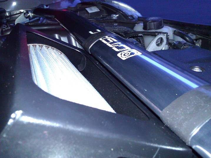

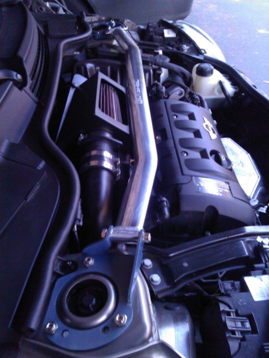

There is about 2 mm of clearance . The bar is definitely not touching the box, even when I wiggle it hard. I wrapped the bar with some silicone self-fusing tape just as a precaution.

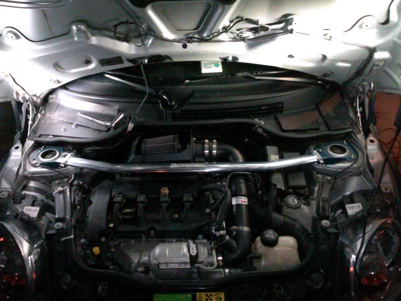

Like this?

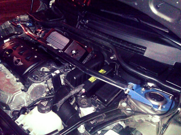

Front.
