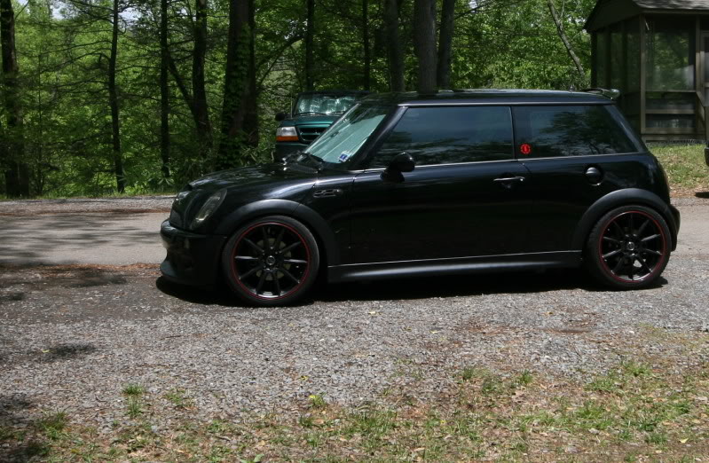

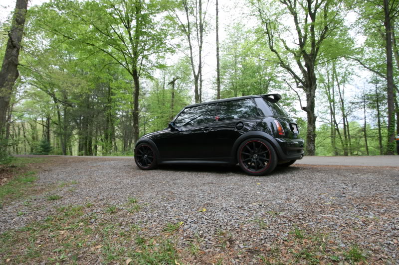

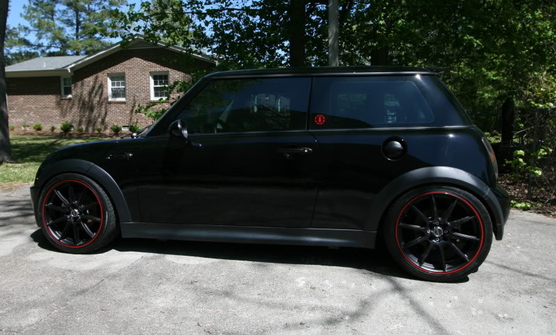

I ended up sending the camber plates back to TSW, they didnt work with these coils. I happy with the coils except the springs are a little soft. Ride height changes when the car is full of gas or heavy passengers, I wish they were a little stiffer. I still have plenty of room left on the coils to go lower if I had smaller wheels. With these 18's and tires that are a little too wide I cant get it lower and still drive it, I'm rubbing when I hit a dip it the road now
How come they didn't work? What was the problem?

They could have worked with a special nut. I was told the my coils were made to stock specs instead of having extended spindle like most. Jeff at TSW said he would rush me the nuts to make the m fit but my car was torn apart in a place were I couldnt leave it for that long. I woulda had to re-install the stock struts, wait for the nuts and take the front end apart again. I chose to go without plates.
I wish that more of these reports would include how stiff that you all thought the springs were compared to stock. Also it would be good to hear the what the springrates are for front and rear so that we can dail in what is stiff vs soft.

Lookin' good 4Boogie!

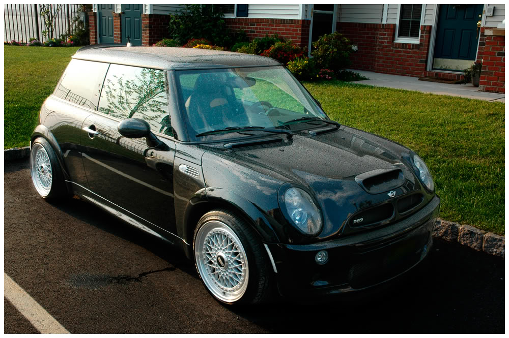

Finally got around to my install/alignment, the coils still need to settle but here is a picture of the car as it sits now, still need to lower the front another inch or so...

This spring I will be installing these modified V3's
They have been changed to 60mm longer front linear springs from the Barrel Non-Linear's.
The rears have had a helper spring added in addition to running shorter rear springs with a slightly stiffer rate to match the rate of the fronts.
I will also be running the TSW Camber Plates:
I will post some pictures once they are installed
