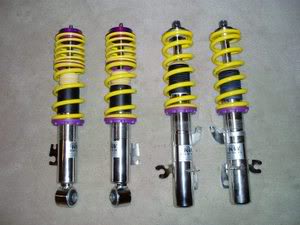

Modified KW V3's...
This spring I will be installing these modified V3's
They have been changed to 60mm longer front linear springs from the Barrel Non-Linear's.
The rears have had a helper spring added in addition to running shorter rear springs with a slightly stiffer rate to match the rate of the fronts.

That'll be a kick-*** setup. More than pics, I want to hear what you think about it post-install.

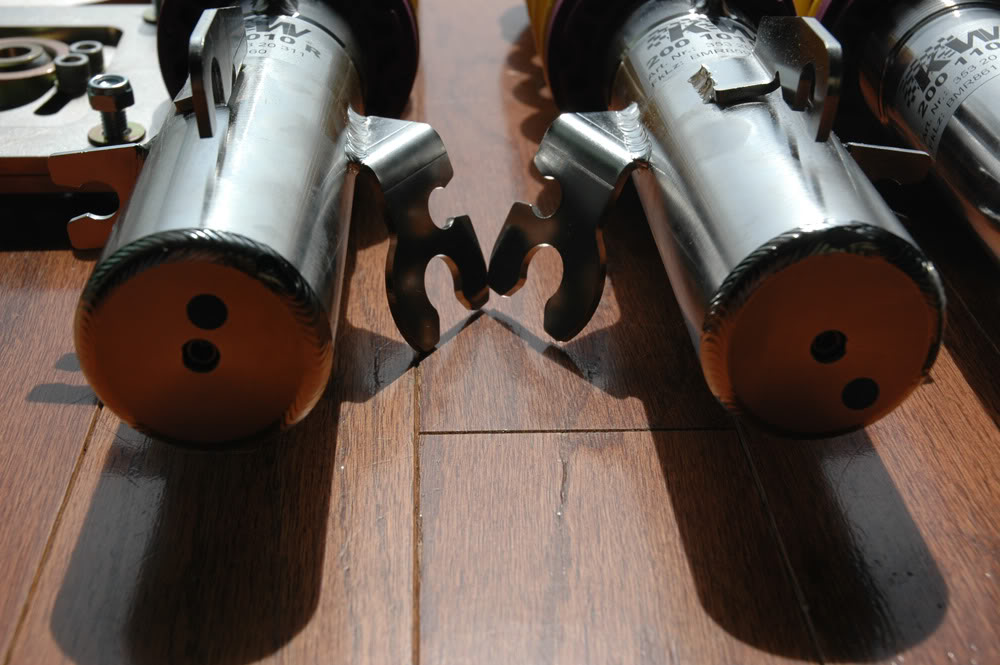

Here are some better images of the new Coilovers for the thread.
More to come when I get everything installed...
