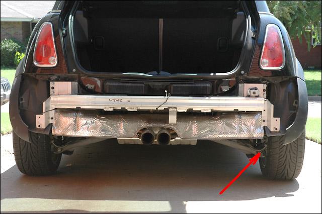

does anyone have a pic or drawing of the rear camber adjustment bolt location? I want to see if I can dial out any of the excess camber on my lowered car - I realize the adjustment is very limited and most likely already set to its maximum 'positive' setting and I should go with some aftermarket control arms but still...

Here:

that's too funny, that's my own car
Originally Posted by chuckt
Here:
W0TM8
